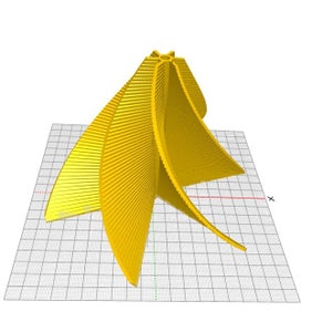

Step 1: CAD Design
The wing spinner was designed using BlocksCAD
