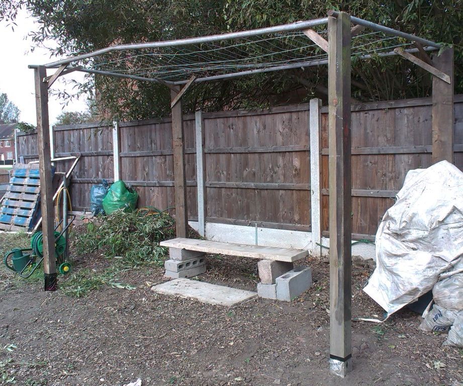

This shows the area I was going to put it into. Luckily, it is a south-facing fence so will get a lot of sunlight.
I began by making the sides with the shelf supports on. The supports are all 67cm to fit across the posts and leave 50cm between them for the shelves to go on. To line up the posts I laid two of them at each end as you can see then nailed the one at the top on. I left the bottom one resting there while I measured where the others should go so they are far enough apart to leave room for growing plants.
Photo 3 shows putting nails in at angles, which, as I said, stops the wood from being able to come apart.
Photo 4 shows the two ends with shelf supports and the top pieces. The bottom extensions were fitted later.

After adding the bottom extensions, I needed to fit the long beams across the top and bottom. These needed extra support to stop it wobbling so you can see in the corners that short pieces of wood were screwed in at 45º. They also have the additional support of metal panels right in the corners, which were originally attached to the fence posts.
Photo 2 shows the middle post added which is necessary to support the middle of the shelves. Three metal brackets were fitted to this, that the shelves would rest on. To find were they needed to go, I rested each shelf on the end supports, held the bracket under it, pushed it up a little (as the wood naturally sags in the middle) and used 2cm screws to fix them in.
Photo 4 then shows how the shelves were placed. I also screwed the brackets to the underside of the shelves to help prevent it swaying from side to side.
Photo 5 shows how the shelves are off-set to allow for sunlight to reach lower down.
I wasn't too pleased about the shelves not being too deep but luckily I had another length of wood that I'd prepared then decided to change so I later added that to the back of the middle shelf.
