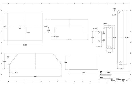

Right now we only have a bunch of electronics wired together, but they aren't really doing anything functional. This is why it is time to build a physical system around the functioning electronics. Again, before actually building the system, I modelled it using Autodesk InventorPro, so that I would know the exact dimensions of the cardboard and wooden pieces that I would be using.
I also designed a mount for the Servo motor. This is the only highly custom-made piece out of all the elements, because it is crafted around the other available materials. I attached the .stl file for a Micro SG 90 Servo Motor, and included the printing settings in the pictures.
Step 6: Building the Structure
After modelling the physical system, it is finally time to build it. I based of my parts from the drawing I made using Autodesk InventorPro to follow the necessary dimensions.
The individual physical parts are shown in the picture and I then glued them together to get a finalized project.
