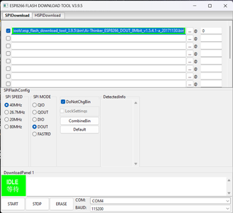

You will need a tool to burn the AT commands firmware. According to the Downloading Guide, you can download the tool from the page -- download the Flash Download Tools there.
For the AT commands firmware, you will also need to download the appropriate AT commands firmware from the page. Say for ESP32, follow the link ESP32 AT Bin, then the link Download ESP32 AT Released Firmware, then download the ZIP file like ESP32-WROOM-32-AT-V3.2.0.0.zip
However, for AI-Thinker ESP01 boards, instead, download the AT command firmware from the page -- https://docs.ai-thinker.com/en/esp8266/sdk
Like uploading sketches, burning firmware to ESP01 also requires some UART to USB setup. I guess the easiest is to use an ESP01 to USB adapter board.
You burn the BIN file Ai-Thinker_ESP8266_DOUT_8Mbit_v1.5.4.1-a_20171130.bin to your AI-Thinker ESP01 board with the Flash Download Tools you download in a previous step
  • Choose the firmware BIN file you downloaded in a previous step
  • The firmware should be burnt to offset 0
  • SPI mode should be set to DOUT
  • Select the COM port your ESP01 board is attached to.
  • Click Start
