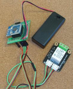

The circuit for the DFROBOT version is trivial (pdf version)
The FET disconnects the DFROBOT Latching Relay (module schematic) when not being switch. If you omit the FET and just connect the -Neg lead to the battery negative then the relay module will draw ~1.5mA continuously. This reduces the battery runtime to ~1month for AAA batteries and ~2months for AA batteries. If you add the FET, see Mounting the FETs, below, for how to mount it on veroboard.
Above is a sample construction without the FET. Using 11 x 0.1' Male Header Pins (DFROBOT FIT0048 ~US$2.90)
Note the RED lead from the relay module plugged into P0.29 to supply the VCC voltage input to the ADC to measure the battery volts.
Upload the DFRobotPowerSwitchComplete.ino sketch to the BLE module to complete the construction. That sketch includes support for driving the FET via P0.31 and a manual pushbutton via P0.30.

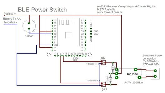

Panasonic Latching Relay Version
The schematic (pdf version) is trivial, except for mounting the very small FETs (see below)
As is the wiring diagram (pdf version)

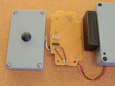

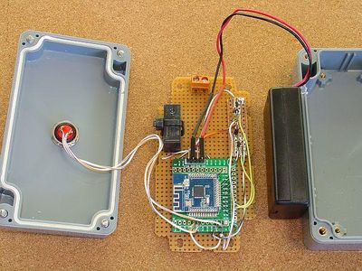

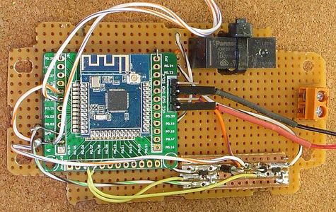

The construction is done using a small square of veroboard for mounting the fets and diodes and the rest of the components were mounted on unclad (no tracks) punched laminate. Note the tie wrap securing the relay to the mounting board. If you are using veroboard for mounting all the components be sure to clear ALL the copper under the relay between the three (3) drive pins and the two (2) switch contact pins maintain the separation between the low voltage BLE circuit and the switched voltage.
Upload the PowerSwitchComplete.ino sketch to the BLE module to complete the construction. (See below for how this sketch was generated).

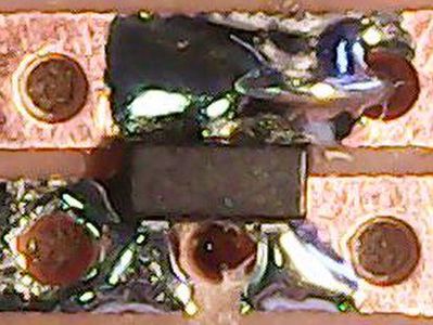

Step 2: Mounting the FETs

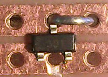

The small FETs can be mounted on veroboard as shown in the photos below. These FETs are very small and inexpensive so order extras for when you loose them on the floor.
Cut one track through hole.
Add wire to fill in the hole so the solder will bridge the gap and position the FET
Tack one leg of the FET with solder to keep it in place and then finish soldering all the legs.

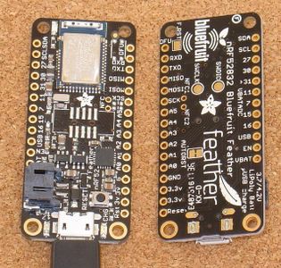

A trivial one button remote control can toggle the Power Switch on/off. It uses an Adafruit nRF52 Feather board (~US$24) programmed with the PowerSwitch_remote.ino sketch. Each time the board starts up it scans for the MAC of the Power Switch and then connects, send the toggle cmd, {T}, and disconnects.
To make the one button remote just insert a momentary push button in series with one of the Battery power leads so that the board starts up/runs only while you are pressing the push button.
You need to update the
const char Client_MAC[] = "F5:FA:14:1C:85:B7"; //  <<<<<<<<< this must match the MAC of your Power Switch BLE
at the top of PowerSwitch_remote.ino sketch to match your BLE module's MAC address as seen in the Nordic nRF Connect app.

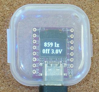

Step 8: BLE Sensor Controlling the Power Switch
A remote sensor, such as a light level sensor can be used, via a BLE to BLE bridge to control turn the Power Switch on at night and off in the morning.
The top line of the display is the current Lux reading. 10 lx is the transition between day and night. The bottom line displays the current state of the Power Switch and its battery volts.

The 01Space ESP32-C3-0.42LCD came in a little plastic box. Cutting a slot for the USB-C cable and adding some ventilation holes made a case that could be mounted with double sided tape. Programming with the sketch and files in LuxToPowerSwitch.zip (needs ESP32 V2.0.6, the SafeString library V4.1.25 and U8g2 by Oliver library V2.33.15) completes the construction.
Note: The 01Space ESP32-C3-0.42LCD is programmed using the Adafruit QT PY ESP32-C3 so that the Serial debug works.
Note: The ESP32-C3 chip gets hot. Some 30degC above ambient. So add ventilation holes to any mounting case.

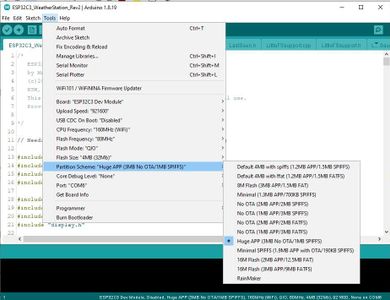

Using the same board as was used above for the LuxToPowerSwitch. Set the ESP32 Partition to Huge APP
Then unzip WiFiLuxPowerSwitch.zip and upload the WiFiLuxPowerSwitch.ino sketch to your ESP32-C3 board. This sketch runs both a WiFi server and a BLE Client at the same time. Connecting pfodApp to the WiFi IP address, (e.g. 10.1.1.71:2989) displays the screen above which lets you monitor the Lux level, Battery Voltage and Switch state (on/off) as well as override the Power Switch on/off state.

The BLE module
A low power BLE module is needed for long battery life. That is one without any extra components. No power regulators, extra sensors etc. There are a number of such BLE modules available. Here the an nRF52832 base module was used because a previous project provides low power Arduino programming support for this chip. Suitable available nRF52832 'bare' modules include:- XL52832-D01 module (and Jessinie nRF52832 Adaptor board), the GT832E_01 with less pins and the Adafruit nRF52832 Bluetooth Low Energy Module – MDBT42Q-512KV2. The XL52832-D01, plus adaptor board, and the GT832E_01 are easier to mount on 0.1” veroboard so they were used to avoid the time and cost of making a PCB.
The Relay
The relay latching is important as it means no power is consumed while the relay of operated. The 277VAC rating covers the 240VAC supply used in Australia and similar voltages used in many other countries. The standard power point current rating at 240VAC is 10A giving 2.4KW power for heater etc. The 16A rating of the relay covers the power requirements of countries that use 110-125VAC (e.g USA) and similar voltages. Because this voltage is lower, more current is needed to get the same power. Typical power point current ratings at 125VAC is 15A giving 1.875KW for heaters etc. (NEMA 1-15 ungrounded (Type A) and NEMA 5-15 grounded (Type B). Both Australia and the US (and other countries) have higher rated wall sockets e.g 20A etc. but the common household appliances sockets are 10A (for 240V) and 15A (for 110V) respectively.
The Panasonic ADW1203HLW latching relay has 3V coil version and a 277VAC / 16A contact rating. The dual coil version was chosen to simplify the driving circuit. The coils take 133mA to operate and so need a transistor/fet to interface between the BLE module pin (maximum 10mA in High Drive mode) and the relay coil. The dual coil common pin is the plus pin so the coils need to connected to ground to switch the relay. Transistors could have been used but that would require two extra base resistors so FETs where chosen instead.
The driver FETs
FETs are used here to avoid adding the additional resistors need for transistors. (Note: For optimal switching small gate resistors are used) FETs often/usually have a bias gate resistor to ensure the FET is not turned on by a build up of stray charge on the gate. Those resistors are also dispensed with here and the BLE module driving pin is used to provide a hard ground for the FET gate to keep it turned off. There can be transient FET turn-on when the circuit is powering up, before the BLE module pin is set as an output and switched to LOW, but that can only happen every 4 years or so when the batteries are changed.
Having decided to use FETs to drive the relay coils, suitable and available FETs needed to be selected. The component search function of electronic component suppliers like Digikey, Mouser, Element14 etc and be used for this. The main requirements are an FET. N-Channel, In stock, with a low On resistance when driven by 2.4V gate drive. So the Vgs (th), the Gate-Source thresh hold voltage must be well below 2.4V so that the FET is switched on hard by a 2.4V gate drive. So say Vgs(th) less than 1V. The On resistance also needs to be low because the 2 coil 3V latching relay coils are only 22.5 ohms. So a 2 ohm FET Rds (ON Reistance Drain-Source) will reduce the voltage on the coil by 10 percent. A FET with an Rds of less then a few tenths of an ohm is desirable. So say less than 250milliohms (0.25 ohms) maximum Rds, Then you can filter by case style. Here an SOT-23 / SOT-23-3 case was specified and that limited the results to 5 items :- ZXMN3B01F, FDN337N, TSM320N03CX, DMN3300U and DMN3200U.
The BLE module runs from 1.7V to 3.6V, but the relay has a minimum coil activation voltage of 2.4V so the low voltage turn off was set at 2.4V. With 2.4V available to drive the FET, any of the 5 FETs can drive the relay coil. The TSM320N03CX was chosen because it has a very low On resistance which makes it a better choice for the Low Power Switch (see below).
The relay driver FETs are required to carry the coil current of 133mA without exceeding the maximum junction temperature. As discussed below, the SOT32 cases can handle this current with a suitable gate drive.
Flywheel Diode
When the relay coil is turned off its magnetic field collapses and generates a current flowing in the same direction. The coil produces a voltage sufficient to drive this current. Without the flywheel diode to conduct the current, the generated voltage is a very large spike. The flywheel diode need only be a general purpose diode capable of currying the coil current, 133mA and with a reverse voltage that exceeds the supply voltage. 1N4001/4 are suitable general purpose 1A rectifiers with 35V (1N4001) / 400v (1N4004) reverse voltage.
Low Power Switch
The 'standard' Power Switch uses the latching relay. The relay contacts are rated for 5VDC/100mA to 277VAC/16A. At low voltages and low currents, there is insufficient “wetting current” to break down the surface film resistance of the contact and the relay will appear to be open even when operated. For Panasonic ADW1203HLW the minimum load to be switch is specified as 5V / 100mA. For controlling lower DC voltages and/or lower currents, the relay can be replaced with a FET. Because the Vgs voltage is supplied by the BLE module and is completely independent (floating) of the voltage being switch, you can use this to switch any DC voltage and current the FET can handle. The Vds breakdown voltage of the 5 FETS are all 30V so that limits the maximum voltage that can be switched.
The TSM320N03CX needs has a much lower On Resistance (max 40mOhms at 25degC ambient with a 2.5V gate-source voltage) than the other FET considered and so can carry more current without overheating. See the Power Handling calculations below.
SOT23 Power Handling for the Low Power Switch
The Low Power Switch is specified for switching less then 24V and 2A. Need to check the FET will not melt caring the 2A. All the FETs have an SOT32 case. With minimal pads the Junction to Ambient thermal resistance is ~250C/W (an-1025.pdf). So for 80degC ambient and max junction temperature of 150decC (150-80)/250 = 280mW dissipation.
The TSM320N03CX with a 2.5Vgs has an On resistance of 0.04ohm (max at 25degC) and ~1.8 x 0.04ohms at 150degC junction temperature => 0.0.72ohms. So for a 2A load current the dissipation is ~144mW which is well within the 280mW maximum above. At 2.4Vgs, the On resistance will be only slightly higher, so the turn off voltage limit for the Low Power Switch was left at 2.4V.
Low Power Switch Reverse Voltage Protection
All the FETs have an un-avoidable, a parasitic diode in their construction, visible in their schematic symbol. If the polarity of the external wires connected to the Low Power Switch are reversed the load current will flow through this parasitic diode and the switch will just appear to always ON. However the forward voltage of this parasitic diode is usually relative large for a diode, about 0.65V at 0.5A/85degC. For small currents this is not a problem but for the 500mA maximum specified current, the results in ~0.33W dissipation, which exceeds the estimated maximum power handling of the SOT23 case (above). A simple way to avoid the problem and protect the FET from thermal breakdown when the voltage is reversed is to prove an alternative path for the reverse current but adding a parallel Schottky diode. For example a 3A B330 Schottky diode has reverse voltage rating of 30V and forward voltage that is less than the FET diode voltage at all temperatures so the reverse current preferentially flows through the Schottky diode instead through the FET parasitic diode.
However Schottky Power diodes have a downside of relatively high reverse leakage, e.g. B330 has a reverse leakage current (at 30V Vds) 0.1mA at 25degC ambient and 20mA at 100degC ambient. This compares to only 1uA (0.001mA) at 25degC Ambient temperature for the TSM320N03CX. It is a design choice as to whether this Off leakage is acceptable for the reverse polarity protection.
For this design of the Low Power Switch, a reverse voltage protection diode was not added.
