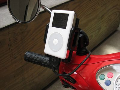

Step 11: IPod Mount
Then I screwed on the iPod mount, assembled the Kensington clamp and cut off the excess screw.
Step 12: IPod Connector/wire
Then I fished the iPod connector under the rubber mirror gasket and into the handle bar cowling. From underneath the handlebars I was able to continue fishing it down and out the center of the steering shaft.

Step 14: Reassamble the Vespa... and Viola!!!
Finally I put the glove box panel back into place basically by reversing the disassembly process. Enjoy the pics of the completed project.
