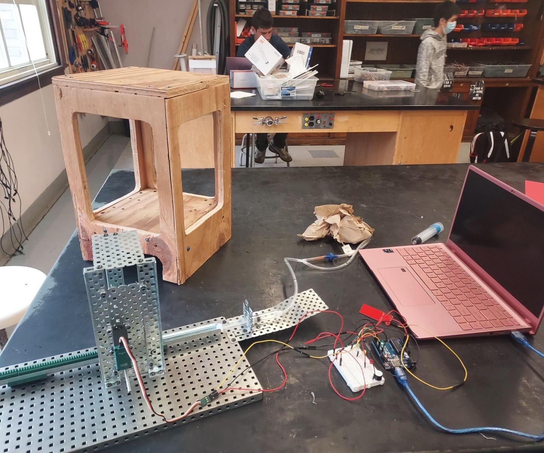

Our robot combines a VEX kit engine and frame with an Aurduino brain controlling these components. The robot will receive inputs from a ultrasonic sensor that tells it when to turn to avoid hitting obstacles. The use of omni-wheels makes the “Roomba” more mobile and allows it to turn and drive in any direction at any moment.

Step 1: Build the Frame
To start, gather your V5 Vex kit parts and create an open flat frame of your choice make sure that it has space for a motor facing each direction.
Step 2: Wiring
For the wiring of the car, you will want to follow this diagram. Use the prototype expansion module to get 5 extra 5 volt and ground ports each. Another very important step is to ensure that the transistors are facing the correct direction. Using the diagram, the side that is facing up should be the flat side. If possible, place the ultrasonic sensor on a different, preferably smaller breadboard so it has more freedom of placement. Connect the vex motors to the bread board.
