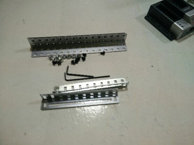

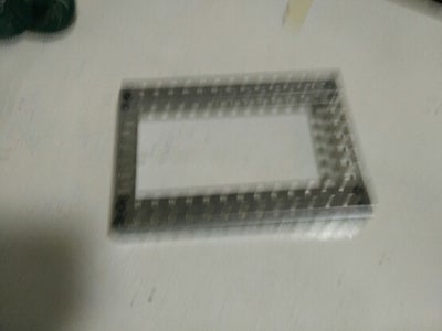

Step 2: Assemble the Chasis
Connect a bumper with two 10-hole angle bars with 8/32 x 0.5" screws. Now connect another bumper to the other end of the two 10-hole angle bars like shown in the picture. Screw the front end of the VEX EDR controller the 4th hole from the front of your Chasis. Screw the rest of the holes in place. It should fit perfectly.
NOTICE: Controller is upright in adjustment step, it is optional to make this change.

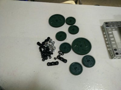

Step 3: Construct the Left Gear Train
Build like shown in the video.
The gear ratio is 1.6 to 1
We chose this gear ratio since it offered more speed in exchange for a bit of torque. The input RPM is about 228 output RPM is 380. Our input torque is 1.67 N*m and output torque is 1 N*m.

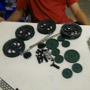

Step 5: Place Long-bar and Wheels
Place the 16 hole long bar on left and right side on each side's 3 axles. This is to cover and protect the gear train. Make sure all axles have cuff's on both sides of the long bar or a wheel followed by a cuff and a cuff to either side like shown.
The theoretical speed will be 248.7 cm/s but the actual speed is 125 cm/s.

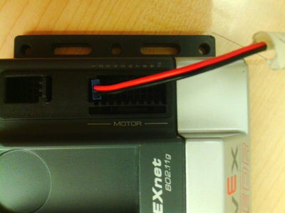

Step 6: Connect Motors to Controller
Take the motors 2 pin port to the appropriate motor ports on the VEX EDR Controller. It doesn't matter which one you put it in or which way just make sure that you keep account of the motor port #.
