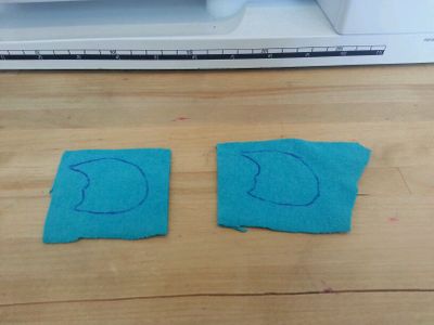

Step 3: Tracing the Feet and Horns
I then traced the outline of the feet and horns so that I would have stencils for them as well.

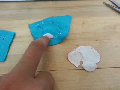

First, I cut out the shapes using the stencils as a guide, I cut a little bit larger than the stencil to allow for extra space in case the body gets pulled around and makes a hole, this will allow for the body to still be intact even with a bit of stretching.
Then, I carefully sewed the white heart onto the half of the blue body and then then to the other half so that there would be a seam created that could be hidden on the inside of the poro. I then finished it off by sewing the blue parts together. I left a hole around the poro’s back in order to leave room for to make a hole. This hole is used to help you sew the horns and feet as well as creating a space for the electronics, that will be placed inside the poro to be accessible.

I then sewed the feet. I sewed the black portion of the foot onto the blue parts before I sewed the 2 parts together (all around) to form the foot. Unlike the body, I simply sewed the white sections, the “foot-pads” directly onto the foot. I figured it didn't matter as much with the feet as it would with the body.
I also cut a line near the middle back of the foot . This is the hole that will be used to connect the body to the foot. This also allows you to flip the foot inside-out so that the good side of the can be seen.

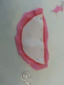

I traced out a stencil for the mouth, laid it on top of 2 layers of a pink cloth and then sewed all of it together except for the straight side. This is so that it can be stuffed with the Hall Effect sensor as well as stuffing.
I also made the little ruffles that are seen above/on the poro's tongue. This was a struggle at first since the little bumps are so small, but I then asked for some advice from a co-worker who suggest to make little snips, on the inner part, near where the bumps dips in. This is so that the fabric wouldn't have to pull so much on a single point is allowed to fan out a bit.

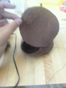

Step 14: Adding Velcro Around the Edge of the Hole
I sewed some Velcro directly around the edge of the hole. This is so that I would still be able to have an opening to get to the electronics and the battery if I ever needed to swap anything out.
