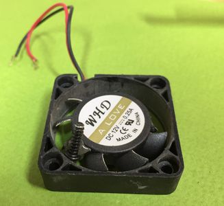

Step 3: Vibrator
use a 12v computer fan as a vibrator
glue a screw (or two screws) to fan blade
