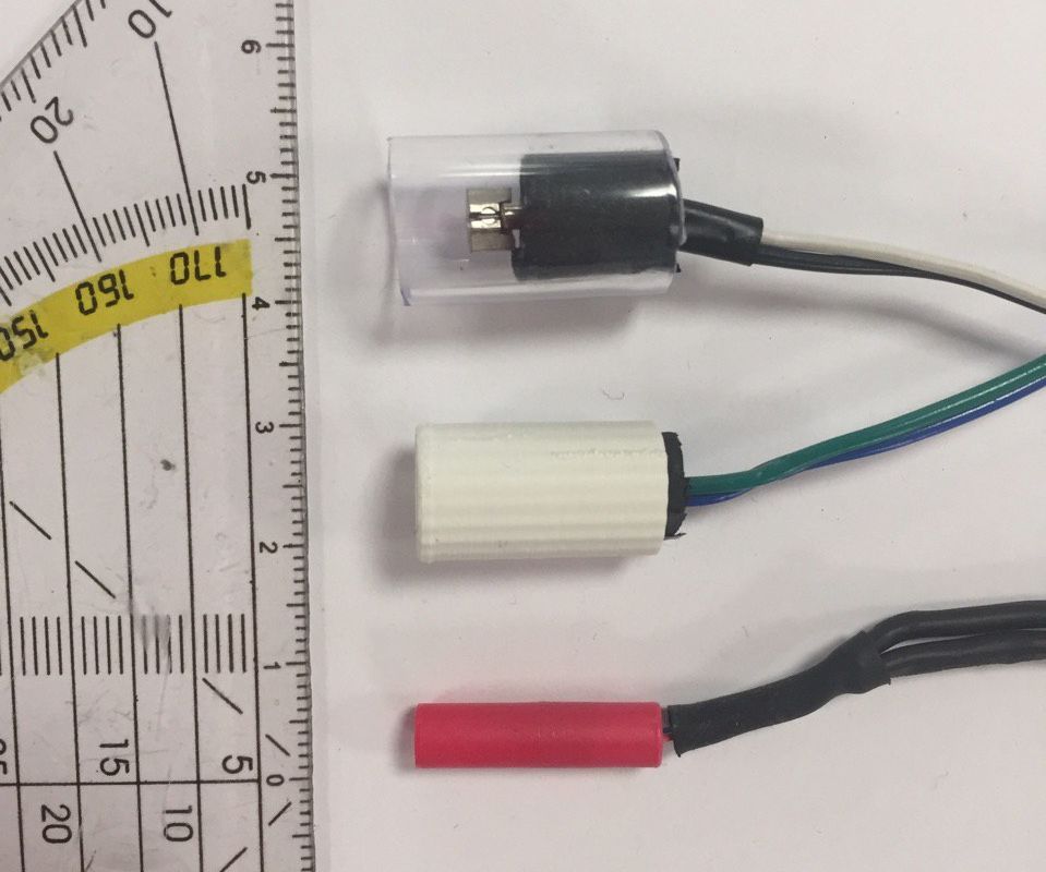

Solder longer wires to the motor
As most of the motors come without or very short and thin wires, it makes sense to extend them by soldering them to longer and more robust wires. Here is how you could do that:
- Remove the plastic around the end of the wires and position them so they are in touch with each other along their exposed wires, like in in the picture.
- Solder them together by touching both wires' threads and letting the solder flow over them.
