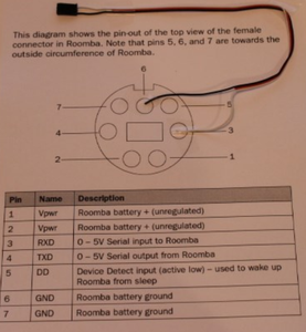

Step 6: Connecting the EZB V4 to the Roomba 530:
Full disclosure, I did test the connections at the very start of the build simply using the Roomba, the EZB and LiPo battery and jumper cables to make sure they were both communicating. Then in EZ Builder, I added a Roomba movement control panel, set it up and tested. Full information for Roomba and EZB V4 connections and control can be found using the following link… https://synthiam.com/Support/Skills/Movement-Panels/iRobot-Roomba-Movement-Panel?id=19164

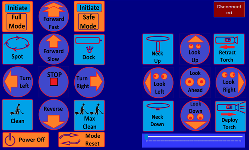

  1. The main EZ Builder control panels I used for Vic were…
  2. iRobot Roomba Movement Panel,
  3. Script Managers,
  4. Mobile Interface,

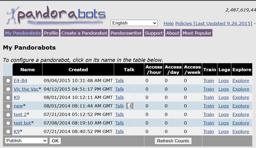

  5. Pandorabot,
  6. Speech recognition
  7. Ultrasonic Radar scan
  8. Auto Position (for servo actions)
  9. Soundboard v4 (for the EZB)
  10. Custom Movement Panel (for custom Roomba/servo movements)
  11. Camera
  12. Speech Settings (for selecting the voice)
  13. and various control panels for monitoring sensors and assigning actions to them, setting a random eye blink, setting RSS feeds and setting scheduled events such as medication reminders, vacuuming, alarm reminders and more.
Each control panel has a question mark which takes you to user guides for that panel. These go into detail of what the panel does, how to use them and sometimes gives simple examples you can build on.

Custom Mobile App:
Vic’s autonomous abilities were as entertaining as they were useful, but there were times where manual control was needed. I used the removable mobile phone as a remote control to get Vic to do things manually. To do this, EZ-Builder has the ability to create your own mobile app which you can use on an Android or an Apple iOS smartphone or tablet, or on a Windows computer. It gives the ability to add a lot of the features of the main EZ Builder software and you can make your own buttons etc.using paint programs or apps so you can give the overall UI your own unique look. The one made for Vic seen in the attached screen shots was a collaboration between myself and my friends 9 year old daughter, mainly she designed it and I helped her put it all together and make it functional.
The background colours and app buttons were all made using Microsoft Paint which has limitations, but with some lateral thinking you can make some fairly good things. The control buttons where scripted as toggle buttons as it saved a lot on screen real estate on the app screen where you don't have to have separate On and Off buttons for example. Here is an example of a simple movement script, press once to move forward, then press again to stop...
if (!$pressed)
Forward() $pressed = 1
ELSE Stop() $pressed = 0
endif
This above script uses a variable and needs to be set first off. You simply do this by placing a script in the EZ Builder connection control that only runs once during start up, and is as follows...
$pressed = 0
Most of the app buttons are set to toggle their controlling features. Not seen in the photos as it was added later, was a camera window which worked great as part of a home security system and checking on pet’s etc. as you could also access Vic via a cellular connection so you could be out of the house and still control him. Once you have finished designing and programming your new mobile app, you can save it to EZ-Robots "Cloud" server where you can access your app on your smartphone or locally.
Step 8: Personality (AIML):
With the likes of ChatGPT, Gemini, CoPilot and other large language models (LLM), AIML has become a lot less relevant for giving a robot a personality, but it is still available and a good way of having a robot personality stored and accessed online, there are ways to store and use your own AIML bot locally without having to rely on an internet connection. Pandorabots legacy models found using this link...
https://www.pandorabots.com/botmaster/en/~1fc02ea107b515a53532ea8b~/home?expired=true
This still functions very well, but they do require a lot of work to give a robot a large personality and relevant database. A lot of copy paste and editing is a quicker way of making a database with asking a single question multiple ways (What’s the time, What is the time, Do you have the time, What time is it etc.) and then to get either a single response or multiple similar responses. The more you put into it, the better it becomes, but it is very time consuming and you have to be careful you don’t repeat the same responses to different questions (unless you do it correctly) as your bot will get stuck in a loop, respond in gibberish or not respond at all. Although as AIML and Pandorabots is open source, there are free Full AIML personalities available which you can use as is, or customise and save it as your own which makes life a little easier.
It’s not for the faint of heart, and with the emergence of AI and LLM’s with the ability to now create custom GPT’s with custom default personality and/or knowledge prompts, This would be a far quicker and more elegant way of creating a proper AI robot personality.
But that said, I would like to give a short example and explanation of a simple AIML segment. The following starts with a question you could possibly ask your robot, then the robots response follows…
<aiml>
<category>
<pattern>WHAT IS AIML</pattern>
<template>The ALICE software implements AIML (Artificial Intelligence Markup Language) a non-standard evolving markup language for creating chat robots. The primary design feature of AIML is minimalism. Compared with other chat robot languages, AIML is perhaps the simplest. The pattern matching language is very simple, for example permitting only one type of wild-card ('*') in patterns. AIML is an XML language, implying that it obeys certain grammatical meta-rules. The choice of XML syntax permits integration with other tools such as XML editors. Another motivation for XML is its familiar look and feel, especially to people with HTML experience. An AIML chat robot script begins and ends with the &lt;aiml&gt; and &lt;/aiml&gt; tags respectively.</template>
</category>
</aiml>
An AIML file starts with the <aiml> tag and ends with the </aiml> tag. The <category> does exactly that, sets a category for the conversation subject matter. The human input, what you would ask/say to the robot fits in between the <pattern> and </pattern> tags and the robots response fits in between the <template> and </template> tags (the tags without a forward slash “/” is an opening tag, and with the forward slash is a closing tag). The following link is a full tutorial I wrote that goes through the whole process of making, editing and publishing a Pandorabot, as well as showing you how to add and use the Pandorabot control panel and how to control robot actions using AIML...
https://synthiam.com/Community/Tutorials/Pandorabot-tutorial-16321/1
