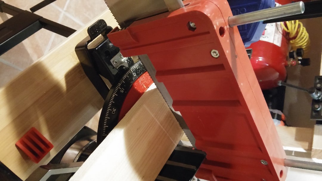

Step 2: Cut
Saw the wood to the appropriate size.

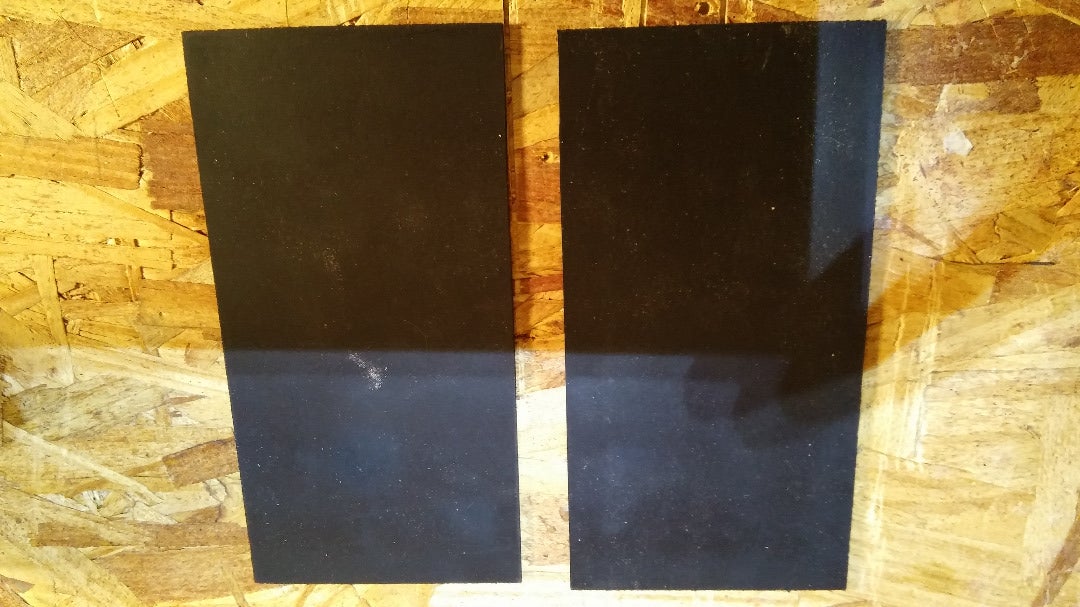

Step 6: Cut Rubber
Cut some gasket rubber to the size of the wood blocks. Tooling leather would also work well for this purpose.

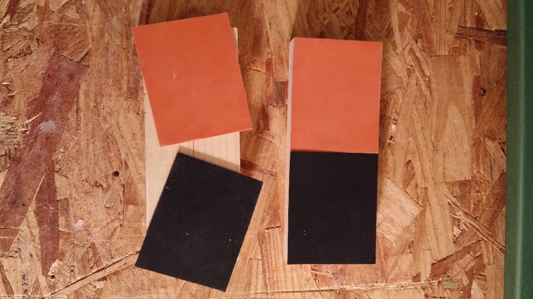

Step 7: Glue
Epoxy the rubber pieces to the wood.

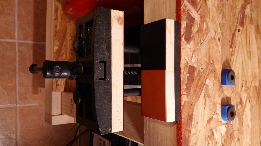

Step 8: Complete
Attach the pads to the vice.
