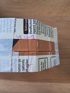

Step 1: Boiler

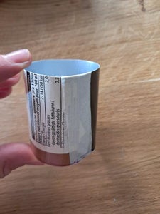

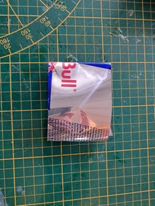

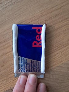

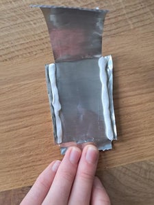

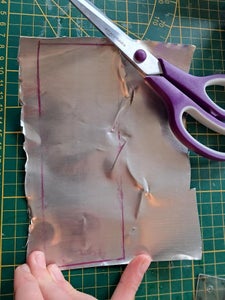

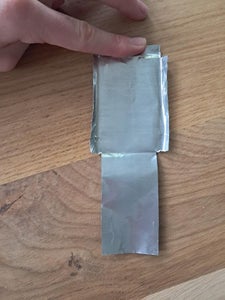

- cut out a 7 x 17 cm piece from the can
- cut out a 1 cm rim

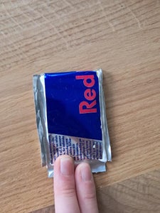

- fold it over
- add blue tack around the edges
- fold the tab over
- add more blue tack around the edges
- squeze with some tweezers

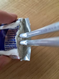

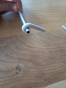

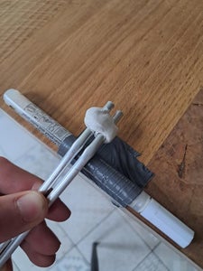

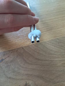

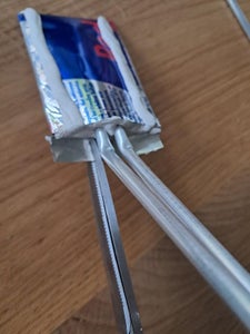

- take your first tube (12 cm long) and roll in blue tack
- roll in the second tube
- attach a pen to your table (for a good bend) and bend the tubes to a 30 degree angle 3 cm away from the edge

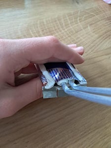

- place them in the boiler and add more blue tack
- cut twice next to the tubes
- fold these tabs over and squeze with pliers
- place the boiler in some water and blow into the straws
- if there are bubbles, place some more blue tack and try again
You are now done with the hardest part!

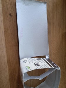

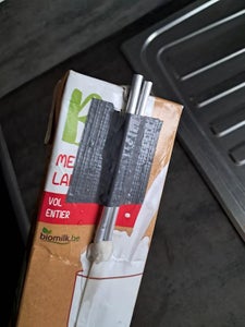

- cut your milk carton in half
- cut a hole about 9 cm from the edge
- place your tubes through and attach to the bottom with duct tape

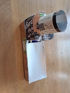

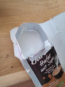

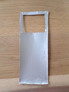

- cut out a 7 x 13 cm piece of cardstock (from milk carton)
- cut out a 5 x 6 cm window
- fold the window over

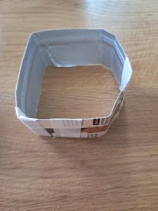

- take some more cardstock and make a 4 cm wide ring
- shape it to mimick the front of your boat
- attach the window to the inside of your cabin
- trace the cabin to make a roof

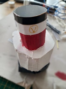

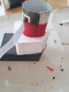

- take some more cardstock and roll it into the chimney
- make a hole in your roof and glue your chimney onto it
- glue everything onto the boat

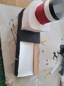

The boat is basically done, all I did was add some decoration and a coat of paint to fit into the Victorian era:

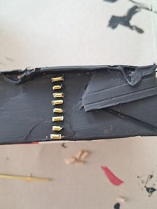

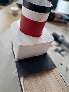

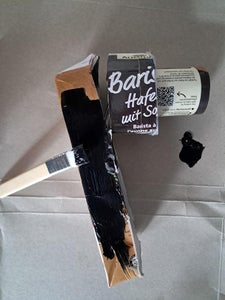

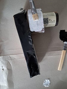

- (spray) paint the boat black/dark blue
- (spray) paint the deck white

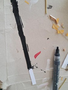

- (spray) paint the chimney red, glue a white and black strip of paper on

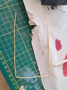

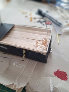

- cut small pieces of gold wire and glue them onto the side of the boat as a ladder

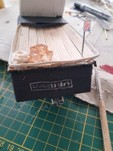

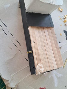

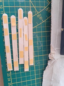

- take your popsicles and draw 3 evenly spaced lines on them
- glue them onto the deck

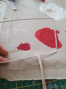

- take a big piece of wire and paint it white
- glue it onto the deck

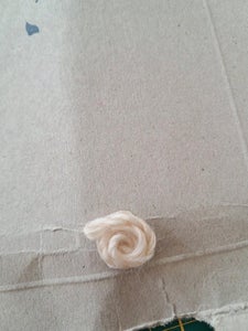

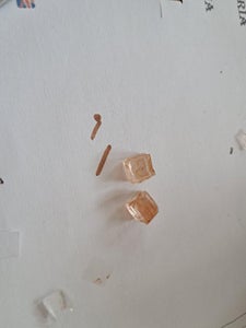

- take some small pieces of nano tape, stack them, paint them brown with a sharpie and glue onto boat

- add a little british flag
- write when your boat was "launched" at the back
