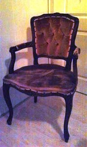

Step 1: Inspiration and Designing
As you might figure yourself, this board was inspired by the style of the Victorian age, which is also the inspiration of most steampunk stuff (which I happen to like also). So I first took a good look at an old victorian chair I own.
Apart from that I wanted it to resemble some sort of a musical instrument, it being a dancer. What else than my antique double bass off course! I love her (yes, her..) and it is big too and made of wood and got nice lines, so technically I only had to put some trucks under it but that would made it to hard to play some jazzy bass-lines. A long with those inspirations I search for other reference pictures online.

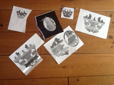

I collected all the pics and started to draw in Coreldraw, but any drawing program can serve this purpose off course, even the olde paper and pencil . When I was satisfied with the lines, I did what I always do when I make a longboard, I printed the outline on paper in real size and glued the pieces of a4 size paper together and cut it out. Usually some kind of poster-maker software can come in handy, for instance in Picasa it is possible but in Coreldraw there is a genuine function for that so you can make really big prints with a standard printer. Because this is a symmetrical design design only one quarter of the board is enough.
The paper design you can glue on a piece of hardboard or thick cardboard and than cut out to use it as a mold to trace.
Because I will make the kick and nose tails in a special way I had to print out the side view too. More on that later.

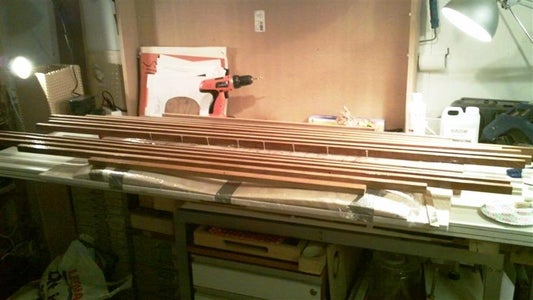

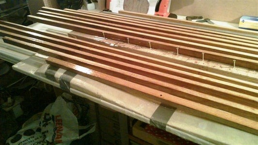

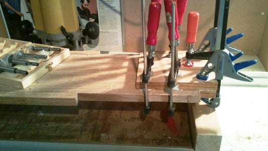

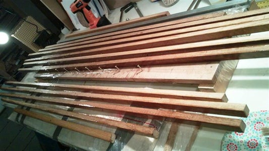

Step 3: Laminating/gluing
Preparation:
First you have to make sure that your strips have flat sides and are as strait as possible. If not use a hand-planer or better; a planing machine. If you saw them out of a plank make sure you saw them on both sides.
Take your time with figuring out in which order you lay the strips out, taking in the direction of the woodgrain, the length of the strips and the appearance of them.
When you are pleased with that lay them down on your workbench with the sides which will be glued faced up.
I have a big 18mm multiplex sheet with two wooden blocks at the ends glued/screwed, so it is raised from the workbench.
On one side I glued a strip of wood to which the first strip of oak can be put against.
When I use glue ore epoxy everything I don't want to be sticked together is covered which a sheet of vinyl tablecloth. This isn't very expensive and can also be used to cover the last layer of a epoxy before it is set. When you remove the sheet after the epoxy hardened it leaves a very nice and shiny skin.
Make sure you have enough clamps (and more) laying around in grabbing distance.
Mix the epoxy according the formula from the supplier. Make sure only use plastic cups, stirring sticks and brushes which you can dispose afterwards. Wet epoxy can be removed with vinegar but it isn't worth the effort. When I mix my epoxy in paper cups I usually poor the stuff out on a paper plate: Epoxy will cure faster in a small cup than spread out on a plate and the the heath development from the chemical reaction can be quite heavy so plastic cups can meld!
After mixing your epoxy brush the stuff thick enough, but not to much, on the sides of the strips. Keep an eye on the time because of the pot life. Then when all strips are glued put them together on the multiplex board and clamp them together firmly along whole the length. I screwed some screws on the sides the clamp them even more and even used some wedges between them.
Then wait, for at least 24 hours, better is to wait at least three days (But that can be quite hard if you are impatient..) before removing the clamps. You now have a "blank".

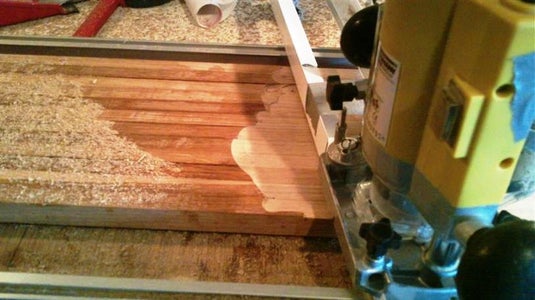

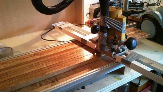

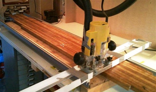

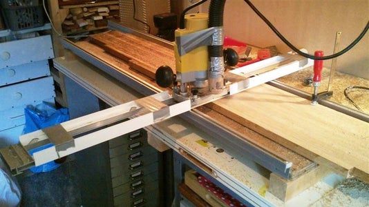

Step 4: Planing
I didn't have entrance to a planner at the time because I made the board during my summer holiday. In the school I work I normally would have used the machine in the wood-shop. But hey, nothing gives a better feeling than doing some good (half machine) hand work. So I made a jig from some aluminum and plastic angles. Combined with two aluminum rails over which the jig slides it worked out pretty nice and I ended up with a nice plane and smooth board.
You have to take a look at the pictures to figure out what I have done. It isn't too hard.
This planing is important because the stips still differ in hight. It is now a good plane to glue the blocks for the kicks and do the carving.

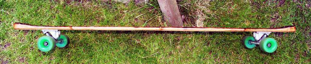

Step 5: Glueing the Kicks and Sawing
After the glue had set I draw the outline on the board with the molds I made. Because I wanted an elevated kick-tail and nose-tail I glued two blocks at either end. I had calculated those in in the length of the board and were sawn off after the strips had been glued together.
After glueing those I let the PU-glue set again and then saw out the form with a jig saw. Keeping a few mm away from the lines on the outside so I had some spare wood for routing later.

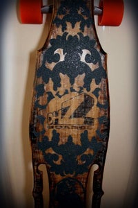

Step 6: Sculpting, Carving and Routing
After the ouline was sawn out I started to draw the silhouette from the side on the nose and tail. I then made cuts until reaching the line and chopped of the pieces with a chisel. Then I did some rasping,sanding and planing and started with the carvings of the curls on the nose and tail. A big job was carving out a subtile curve on the whole length of the board, the concave. This is to lock your feet in a bit and giving some leverage when turning the board. I carved little chips out of the platform, intended for use as grip. Later I added normal grip-tape because it wasn't sufficient after the epoxy and fiberglass on the deck.
Than I used my router again to carve out the edges with some beveling to add a real 19th century look to the board and smooth finish and soft touch for my hands.
I finished with carving out the picture of the dancing girl, my logo and a line all around the board. I used a woodcarving set for the wood-cuts.
After the carving I sanded the board and filled the carvings with gold paint.
