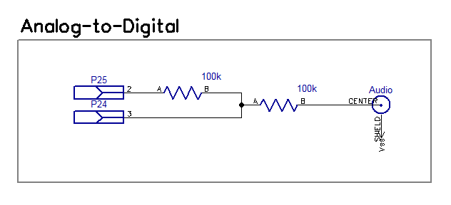

- Bridge C2 - this will allow us to use the Audio RCA jack as an input.
- Jumper R8, as shown in the photo, to go to a 100k resistor. The other end of that resistor will go to P24.
- Connect P24 to P25 through the second 100k resistor.

Step 3: Understanding the Circuit
There are two parts to the circuit we've built;
We'll program one pin (D on the schematic below) on the QuickStart to do something very simple: whenever it senses Vdd, connect a second pin (/Q on the schematic) to ground. Whenever it senses ground, connect the second pin to Vdd.
What happens if we connect /Q back into D? This is what we get;
If there's no analog input connected, /Q will flip on every clock cycle (%50 duty cycle);
Most ADC's use Sigma-Delta, whether it's built into the pins, or is external, like on the QuickStart, there's an even more detailed article on Wikipedia on how sigma delta works, but hopefully my brief explanation will get your started. It takes just a little bit of code to do Sigma-Delta, and it's already in our code.
Reading the Audio Signal
The audio signal comes in analog, we use a 'Sigma Delta' circuit to convert that to digital values;
What is Sigma-Delta?
Computers live in a binary world - there are only two values, Vdd and ground. Unfortunately, signals like audio have values between Vdd and ground that we want to read. Sigma-Delta is the most common technique for reading analog values.We'll program one pin (D on the schematic below) on the QuickStart to do something very simple: whenever it senses Vdd, connect a second pin (/Q on the schematic) to ground. Whenever it senses ground, connect the second pin to Vdd.

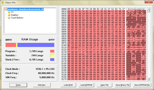

Step 4: Firmware
Download and install the Propeller Tool (Mac / Windows / Linux Instructions) and download the firmware (here) and unzip to a new directory on your desktop. Plug your QuickStart board into your computer and open 'pixelmusic_demoboardconverted_v5' in The Propeller Tool. Hit F8 (or Run -> Compile Current -> View Info) and info dialog will pop up. Hit the button labelled 'Load EEPROM' and your QuickStart will be loaded with the Video Beats program.
There are 4 objects in the program;
pixelmusic_demoboardconverted_v5.spin
Is the main logic of the program, it takes the analog values from the audio and uses them to determine the graphical patterns that are displayed on the TV
TV.spin
This object is the standard TV driver for the QuickStart, it generates an NTSC baseband signal. We get it to run by calling it in our main object with the line; tv.start(@tv_status)
Graphics.spin
While TV.spin creates our NTSC signal, Graphics.spin includes methods that make it easy to manipulate text and graphics on the screen. our main object uses graphics.spin by first starting it; gr.start . Then using the various methods it provides;
This object makes it easy to read the buttons on the QuickStart. We start it with buttons.start(rate), where rate is how often we want to update the button state. Every time we call buttons.state, it will return eight bits - each bit is the state one button. So, if no buttons are being pressed, Buttons.state will return %0000_0000. If button 8 is being pressed, Buttons.state will return %0000_0001, and so on.
