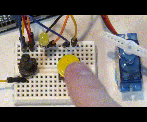

Step 2: Circuit
After the code has been uploaded to the board, disconnect the power. Next, Attach the Bluetooth module to the circuit as seen above:
- GND to Ground
- VCC to 5v pin
- TXD to pin 0
- RXD to pin 1
Step 3: Bluetooth Connection
- Power on the Arduino
- Open your computer's Bluetooth settings
- Pair with the HC-05 module
- Find the module's serial port name in "devices and printers":
- In the Arduino IDE, choose serial port of Bluetooth module (mine is COM10)
- Open the serial monitor as normal to view incoming information
