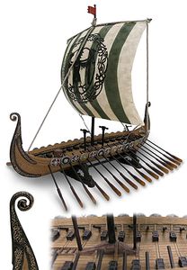

So this is the picture I found on google
