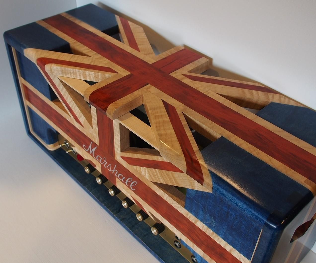

Step 7: Jungle Faceplate
This being a Marshall I wanted the face plate to announce that in a slightly tarnished overgrown jungle way. With a bit of curly maple scrap from the Iris cab build I proceeded to 'string box' cut the maple. This is done on a band saw to cut in the gently curved arcs. Those cuts were then filled with a 1/8" thick strip of padauk and glued back together. Cut and repeat. You might be tempted to cut several arcs to speed up the process as I did. Don't. The resulting oozing, squirming mess was a clamping nightmare. In honor of the madness this project requires I made 22 string cuts.
The resulting Frankenboard was cut to fit and the control panel notch was cut and shaped as well. The original design intent called for chunks of the maple to be removed so a Marshall logo could be seen through the face plate as if the jungle had over grown it. The oozing, squirming, clamping nightmare convinced me to find another way.
Utilizing the bit of carving experience gained on the failed scales I carved the logo into the maple leaving the padauk growing in front of it. I filled the logo with an epoxy and brass powder mixture and sanded the entire face plate flat. A bit of CA [super glue - a wood worker's best friend] to fill the gaps and it was hit with a black tea wash [3x] to make the grain pop then lacquered.
