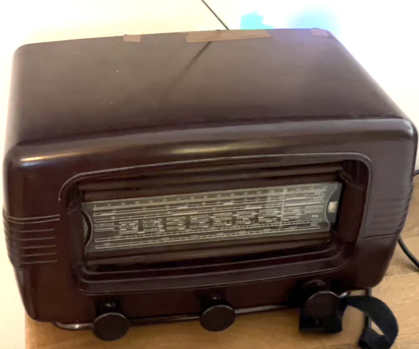

In this instructable, we'll walk you through the steps to set up a Raspberry Pi-powered vintage arcade console that you can connect to your TV. This project will let you play your favorite retro games from classic consoles like NES, SNES, Sega Genesis, and more, all on a single Raspberry Pi.
The best part? It’s simple and doesn’t require a lot of technical expertise.
