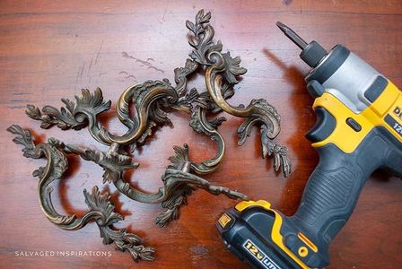

I began by removing all the hardware and then giving it a thorough clean inside and out using a TSP substitute.

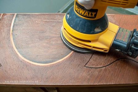

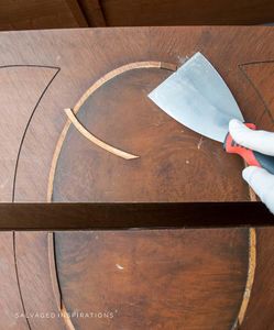

I used a putty knife to remove what remained of the damaged trim on the front oval, then sanded the entire dresser. I used a new trim set to replace the old one and glued them. I like this trim because they are bendable and easy to attach.

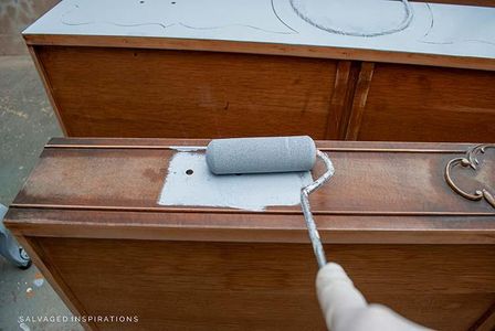

When painting a dark color, a tinted primer comes in handy because it reduces the number of layers required for complete coverage. A primer is also very necessary in pieces like this because they tend to show discoloration and bleed through.

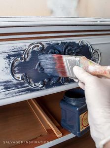

Once the primer dried, it only took one coat of dark navy blue chalk paint to have full coverage.

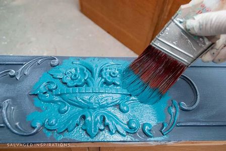

Step 4: Paint Wash

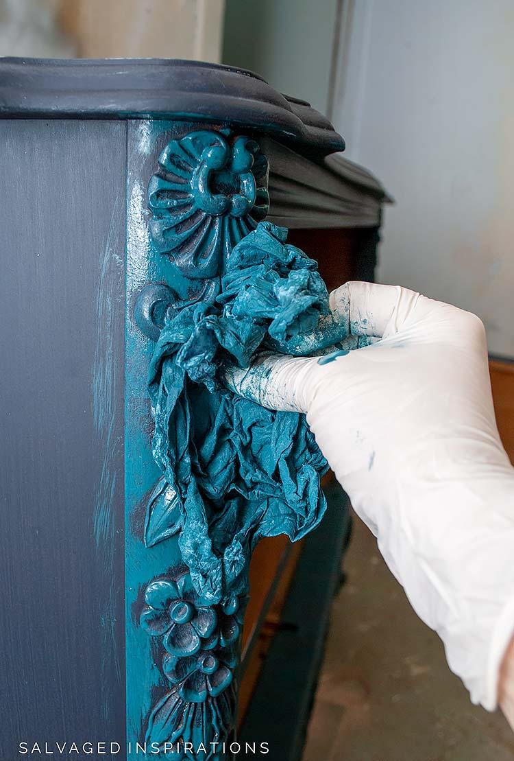

To give the finish a distressed look, I gave it a light sanding first and then paint wash it with dark teal chalk paint.
To do the paint wash, I brushed the paint and then pat it away with a towel.

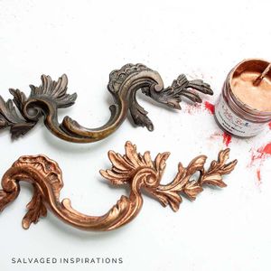

Step 5: Gold Details
To add metallic and gold sparkle to the details of the piece, I used a gilding wax in amber color. The copper-gold color matches perfectly with the dresser's velvet blue color.
I also used the same gilding wax to glow up the old hardware.

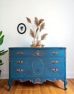

Here's the finished look of the furniture makeover! Never expected that it would look so elegant and beautiful! Love the combination of colors especially the blue velvet finish and the amber gold accents. Absolutely gorgeous!

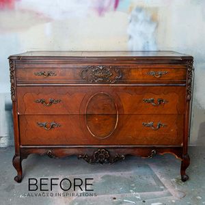

Here's another look at its before and after. I hope it inspired you and gave you an idea for your next project.
