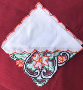

Step 6: The Completed Handkerchief
- Press the hankie and fold it so that the design is clearly visible
- Do try it out and gift it to your loved ones
