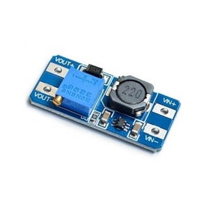

- Step-Up Voltage Regulator module

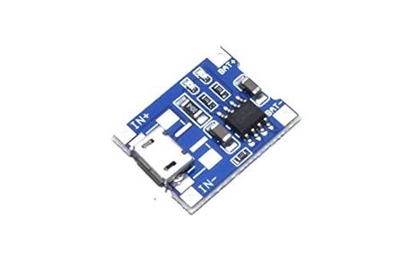

- TP4056 module (only the "micro" version fits well)

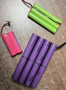

- 18650 Battery (don't buy batteries... reuse them from old devices)

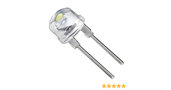

- 8mm Led

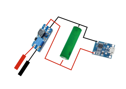

I have many old 18650 lithium batteries in my lab that seemed perfect for the project.
Unfortunately the 18650s are too long to place them vertically in the space of the original battery, so I placed it at an angle, conserving space for the charger module and step up regulator.
The top cap has a hole that I filled with transparent hot glue, to be able to see the tp4056 module leds that indicate the battery charge status.

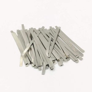

To build the battery contacts I used pieces of nickel strip.
The internal circuit is very simple, just be careful to calculate the length of the cables well, to make assembly easier. The step up regulator is adjustable via a variable resistor and I adjusted it with an output of 4.5v to give the battery the original voltage so that it can also be used with other devices.

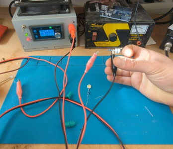

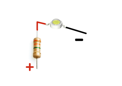

To update the bulbs I created a 3d model of the small "e10" bulb thread. Of course, the inside of the model is hollow to pass the contacts. The upper part of the bulb is designed to fit the LEDs easily.

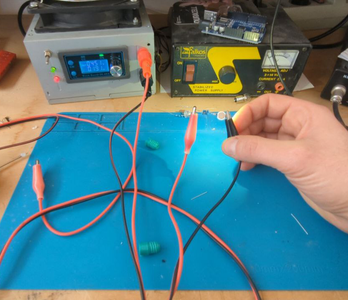

I used 2 types of LEDs I had at home, an 8mm LED which I fed at 100mA with a 10 Ohm resistor and a 1W power LED which I fed at 200mA with a 5 Ohm resistor.
