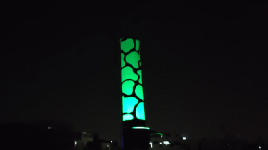

We will cut a beautiful structure out of the PVC pipe which make pipe look good and the lamp is actually RGB led strip which can be controlled by your smartphone.
So just light up the lamp set the colour of your mood and you are ready to get a good vibes in dark.

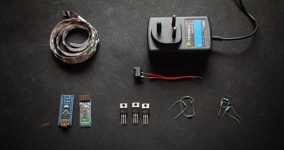

Electronics
  1. Arduino Nano
  2. HC-05
  3. RGB LED strip
  4. IRFZ40n MOSFET X 3
  5. 100E resistor X 3
  6. 10K resistor X 3
  7. 12V adapter

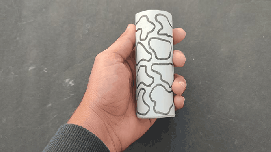

Step 1: Make Design on PVC Pipe
Let's start the project,
Take a PVC pipe, i have found it in dump yard of my landlord, i hope they never need it anymore.
Make some crezy drawing on it with marker, as you can see in image i have made stone like structure in random pattern. There are some space between each stone drawing which connects pipe to be in its round shape.
You can chooses your design according to your creativity, i know you are more creative than me. You will make it very nice. There some more ideas from my side, you can cut strips, triangles circles or any drawing.
For me stone structure is perfect.
After you satisfied with your drawing, it's time to cut the inner design, in my case it's stones, i have cut all the stone woth help of drill machine, just drill at every border of stone and samd it with sand paper for extra smoothness.
Now this part is ready to paint, let's discuss it in next step.

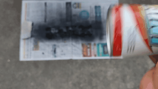

Now it's time to paint it, i am using spary paint becouse it make easy to paint everything, but if you don't have spary paint then any paint can work for it.
To Spray the PVC pipe, first of all go outside becouse gases from the bottle can harm you.
Put a news paper on the floor, there is windy weather outside so i have used two stones on the sode of news paper to make it more stable.
Once the news paper is stable put PVC pipe on it and take spary paint, shake spray paint for 30 second at the beginning to remove any lumps in the paint, and it mix paint with gas properly.
Spary the paint on the PCV uniformly at one side, after drying do it on other side.

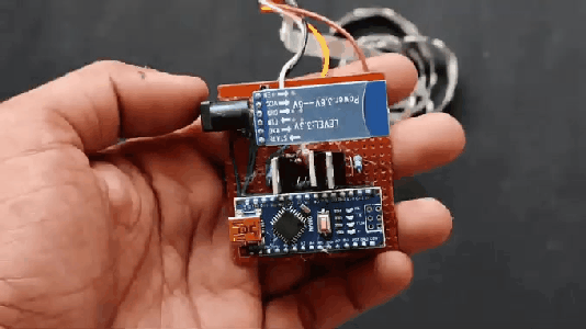

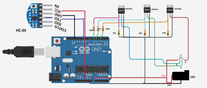

In the circuit diagram, I used an Arduino nano to make things small, Arduino nano is
programmed with several RGB led patterns and colors which can be changed by Bluetooth
command, as a Bluetooth we are using an HC05 Bluetooth module, which receives commands
from a smartphone.
Arduino nano runs on 5V but the led strip runs on 12v so we need MOSFETs, here we are using
IRFZ44n MOSFET, which can be turned on by a 5v signal from Arduino nano and it can drive
led trip. I have used three, one for each color.
As given in the Arduino diagram I have used 10,11 pins as software RX and TX pin to
communicate with the HC05 Bluetooth module. Pin 3, 5,6 is used to control the LED strip color,
this pin has PWM so we can control the brightness of each color.
There is a 100E resistor is connected in between gate and Arduino to control the current and a
10K is connected to pull down the floating gate.
First of all, I have connected all the circuits on the breadboard to test all things are working
properly or not, then I have connected it on zero PCB.
After connecting the circuit, upload the code in Arduino, you can download the code from my
Github page.
Github:- https://github.com/vishalsoniindia/RGB_with_Hc-05

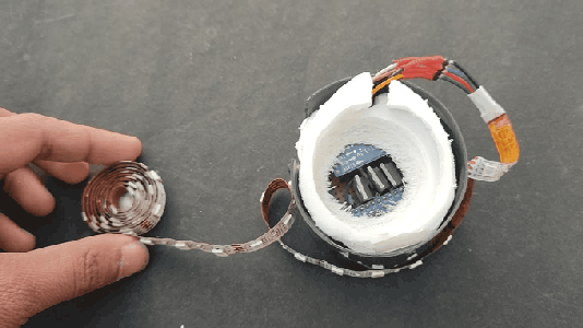

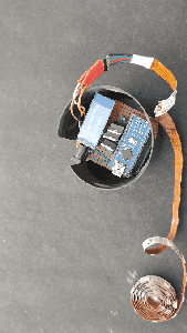

Step 4: Electronics Setup

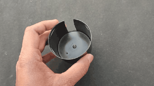

Now the board it self looks very bad out of the lamp so we need to hide it inside.
So i got a spary paint cap which is perfect for stand,
I have inserted the pcb inside the cap and made a cut so we can power it straight in to power jack.
Then i have used foam board to make things tight and stay electronics in it's place.
Now i have made a round roll of led strip which is my bigest mistake.
Warning:- the roll of led strip will heat up the whole strip, result the led will be desolder from it's place.
Solution :- use 3-4 bright RGB with heat shink and make sure there is gap between heatsink and foam board.

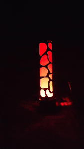

Step 5: Final Setup
Now it is almost done,

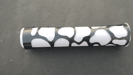

Make a roll of butter paper to defuse the RGB light, put the roll inside the PVC pipe as show in image.
Insert the pipe on the stand which contain electronics, you can fix it in place with hot glue or any other glue. But for me hot glue works best. Now you are ready to go,
Download the app from link :- https://play.google.com/store/apps/details?id=com.rgb.rgbcontroller
After downloading the app go to the my RGB pumpkin project to learn how to use this app.
https://www.instructables.com/RGB-Pumpkin-Wall-Light/
Now you are able to controll light as you want, set any colour according to your mood, if you don't find your colour tell me i will make it available for you.
