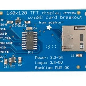

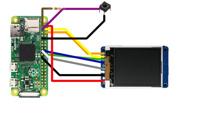

For you electronics buffs, this step should be fun! If you hate electronics, this step might be miserable! It’s actually not too bad. Basically we just need to figure out how to wire everything together. First, let’s figure out the LCD. The small Adafruit TFT LCD’s have similar pin-outs to the one below. It will need to be wired up to the GPIO pins on the Raspberry Pi. You can use the diagram below to see how to wire it all up.
We’re also going to need to connect the button we’re using to snap pictures to the GPIO pins. This will allow us to read the button state so that we can tell if it’s been pressed or not using Python., I used a simple momentary button with a 10k resistor. and connected it (along withe LCD) as laid out below.

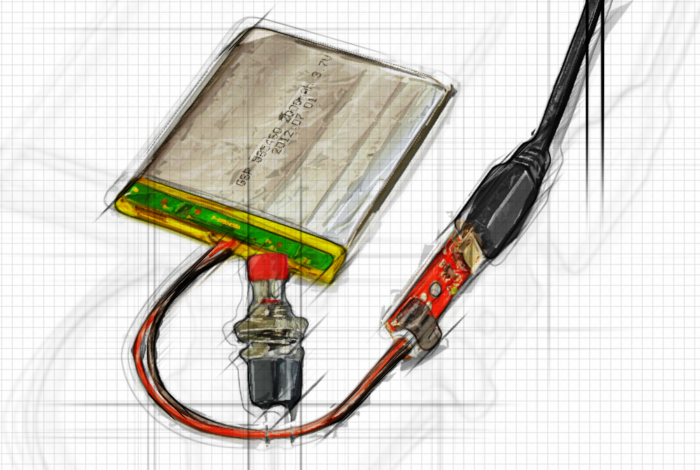

The next thing we need to wire up is the power supply. Since we’re wanting this camera to be portable, it would be ideal to have a rechargeable power supply that can last for at least a few hours. Those emergency cell phone charges you can buy at the store fit the bill perfectly. The one I purchased was slightly larger than a AA battery, so it fit perfectly into the small size of the camera. So that we could turn it on and off easily, I wired the power through an on/off switch before running it to the Pi zero.

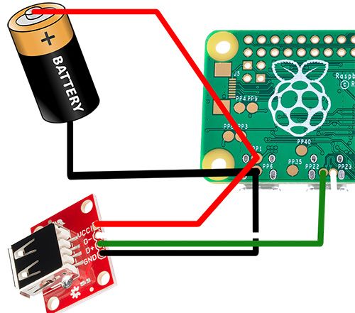

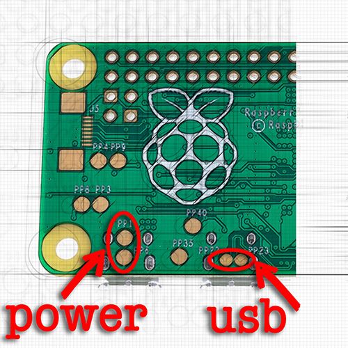

An unforeseen problem that I ran into was that the camera didn’t have enough space for plugging any cables into the Pi zero. It just wasn’t wide enough to support the cables. So I had to figure out another way to run power and USB capabilities (for the wifi dongle) to the Pi. One option would have been to run the power through the GPIO pins, but unfortunately our LCD screen and buttons are already occupying the necessary pins. So another method is to solder the power and USB wires to the reverse side of the corresponding ports on the Pi Zero. IMPORTANT: IF YOU POWER YOUR PI LIKE THIS, YOU CAN NO LONGER PLUG ANYTHING INTO THE POWER PORT ON THE PI AT THE SAME TIME. IT COULD OVERLOAD YOUR PI. You can see more details in the images below:

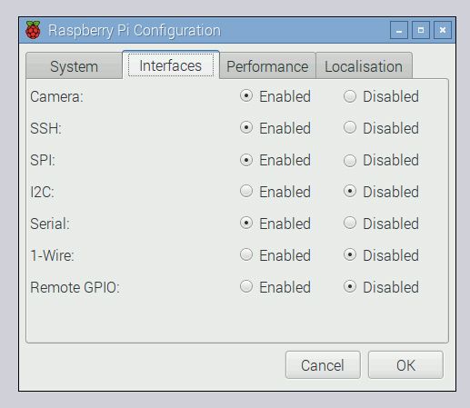

With the hardware side of things done, let’s get started on the software side of things. The first thing we need to do is boot up the Pi. So you need to download the Raspbian OS, burn it to an SD card and put it into the SD card slot on your Pi Zero. Before you power it on, connect an HDMI monitor and a powered USB hub with a keyboard, mouse, and wifi connected. Now power it on and it should boot to the desktop.
The first thing we want to do is give the Pi static IP address on our network so that it will be the same IP address everytime the Pi boots up. To do this, right click on the wireless icon in the upper right and select “wireless configuration”. Then in the first field, type in a static IP address and then click OK. Next we need to click on the menu in the upper left and find the Raspberry Pi Configuration option. Once that window opens up, you want to click on the “interfaces” tab and make sure these items are enabled:
- Camera – to enable the use of our webcam
- SSH – so that we can remotely connect to our Pi
- SPI – to enable the use of our LCD screen.
With those things are enabled, you can reboot your Pi and unplug the HDMI calbe and the USB hub, making sure that the wifi dongle is now the only thing plugged into the Pi’s USB port.
