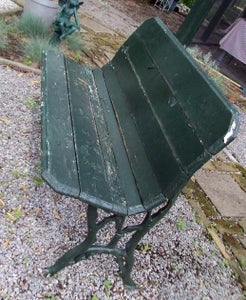

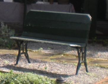

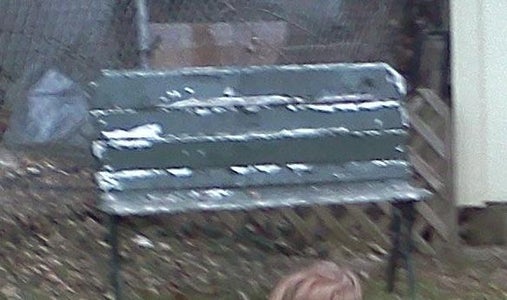

Hi all, I’ve had these vintage school desk wrought iron pieces for, well over a, decade. My mom & dad had converted it into a bench. It was passed on to my daughter but it had deteriorated over the years. When I got it, it was pretty much falling apart. So I stripped it of all the old rotten wood and set it aside with the intention I’ll remake it. Well I did sorta. I cleaned and painted the hardware. Then painted them and well it sat for another 5 years LOL. At any rate this details how I did, Sorry for not having any earlier pics of my progress.
This set of legs are from and old school desk, the hardware is actually the last seat that would appear in a row of desks which would typically all be mounted to two long stringer boards to keep the desks in a row. The other desks would have the actual desk over hang for the person sitting on the next seat behind it and so on until the last seat which would have no desk portion off its back.

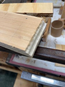

This is where I figured out my cryptic measurements from years gone by. The bottoms of the boards needed to be slightly smaller than the tops so that as they attach to the curve of the hardware they don’t bind up against the other board in the sequence.

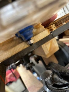

To achieve this I took my hand trim router and used the smallest round edge bit I had to remove the edge so they wouldn’t be touching when assembled. I then switched my router bit to a roman edge and did the ends of each board. For the top board on the back and the front board on the seat I angled the corners about 3” face to the corners. I then routed the top edge of the back and the bottom front edge of each board to finish the roman look.

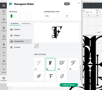

Now about the letter itself... I have no clue what font it is. I actually found it in my Cricut Software in the new Monogram feature. Its under the Handwritten Styles. It doesn't give it an actual font name. I placed it in my software then did a screen grab and redrew it in Abobe Illustrator.

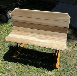

After a couple days I assemble the boards to the legs with the screws. I worked from the center out. So for the seat I did the smaller boards first working outward. Then for the back, start at the bottom and then work up towards the top. It help having done a test assembly earlier as the pilot holes help make it and easier assembly. Once assembled I gave the entire piece a 4 coat of Poly. And left it sitting in my time machine to cure for another 5 years, No!!! just a week. The final step was moving it into place.

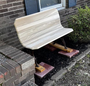

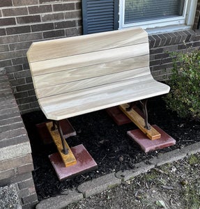

OK technically its not my back yard but I think it looks great sitting in front of my house. Its under the over hang of the front quad level and the huge Hickory tree, so it won’t get much direct weather as its in the shade 80% of the day. It’ll be great to sit out front and watch the neighborhood and yell at those kids to “HEY, get off my lawn". (Joking). Plus it’ll be the perfect spot to sit and pass out candy at Halloween.
Step 7: Placement
For added security I drilled holes in the concrete pavers it sits on and added screw anchors. Counter sunk drill holes through the feet and then screwed heavy gauge mason screws into the anchors. Hopefully deterring anyone from just walking away with it.
