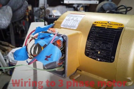

Step 3: Wire the Motor
Wiring the motor is a lot about labeling the wires. I found this video that best explains wiring 3 phase motors for me:
