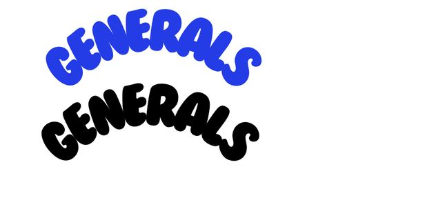

Step 2: Trace on Silhouette Studio!
Import the Image
  1. Open Silhouette Studio: Open Silhouette Studio and start a new project.
  2. Import Your Design:
  3. Click on "File" > "Open" and navigate to your design file (e.g., a .jpeg, .png, or .bmp file).
  4. Alternatively, you can drag and drop the image directly onto your workspace in Silhouette Studio.
Resize and Position the Image
  1. Resize: Select the image, then click and drag the corners to resize it to fit within your workspace. Make sure the size fits the intended vinyl dimensions.
  2. Position: Place the image in the center of the workspace or wherever you prefer for ease of viewing and tracing.
Open the Trace Panel
  1. Access the Trace Tool:
  2. Go to the right toolbar and select the "Trace Panel" icon, which looks like a butterfly with a dashed outline.
  3. Select Trace Area:
  4. Click on “Select Trace Area” in the Trace Panel.
  5. A crosshair cursor will appear. Click and drag a box around the entire image you want to trace.
Adjust Trace Settings
  1. Highlight the Image:
  2. The selected area will turn yellow, highlighting the parts that Silhouette Studio will trace. Only the yellow sections will be traced, so make sure the yellow highlights the full outline of your design.
  3. Threshold Adjustment:
  4. Use the “Threshold” slider to increase or decrease the yellow coverage. Raise the threshold if parts of your image aren’t highlighted enough, but avoid going too high to prevent fuzzy edges.
  5. For images with solid lines, a threshold of 45-55% is usually effective. For more detailed designs, you may need a higher threshold.
  6. Despeckle: If the image has small specks or dots, use the “Despeckle Threshold” slider to remove them. Increasing it will clean up small, unwanted details.
  7. Filter Settings (Optional): For complex or multi-colored designs, try using the "High Pass Filter" or "Low Pass Filter" options for finer control.
Trace the Design
  1. Choose a Trace Method: You have several trace options based on your design needs:
  2. Trace: Creates an outline around the entire image, ideal for solid shapes.
  3. Trace Outer Edge: Only traces the outer edge of the design, ignoring internal details. This is useful for silhouette-style cuts.
  4. Trace and Detach: Separates the traced design from the background, useful for complex multi-color designs.
  5. Apply the Trace:
  6. Once you choose a method, click on it, and the trace lines will appear around your design in red.
  7. Click off the design to deselect, then click on the original image and move or delete it to view the traced outline.
Edit the Trace Path
  1. Refine the Outline: If the traced lines aren’t smooth or need adjustment, use the "Point Editing" tool.
  2. Right-click on the traced design and select “Edit Points.”
  3. Click on any point to move, delete, or smooth it for a cleaner cut path.
  4. Simplify: For complex images with too many points, right-click on the outline and choose “Simplify” to reduce the number of points, which will make cutting smoother.
