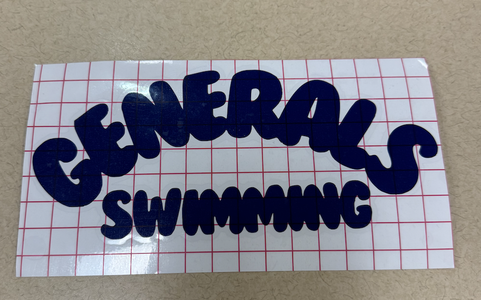

As a member of the swim team, I’ve always felt that our team spirit is something truly special. Whether it's the energy at practice, the camaraderie during meets, or the pride we have in wearing our team colors, there’s a unique bond that brings us all together. But when it comes to showing off that team pride outside of the pool—on water bottles, laptops, or even car windows—I realized we were missing something simple but powerful: custom stickers!
I wanted to create something that not only represents our team’s spirit, but also something fun that we could all use to showcase our love for swimming and our team. Stickers are a great way to bring us together outside of practice, make our gear stand out, and, most importantly, serve as a reminder of the hard work, determination, and teamwork that we put into each race and training session. So, I decided to combine my love for swimming with my creativity and use a vinyl cutter to design custom stickers that could reflect our passion and pride. Here's how I did it!

Step 4: Weed the Design
1. Remove the Excess Vinyl
  1. After the cutting is complete, carefully remove the vinyl sheet from the cutter.
  2. Start by gently peeling off the areas around your design that are not part of the sticker (this is called “weeding”).
2. Use Weeding Tools
  1. Use a weeding hook or tweezers to remove tiny pieces of excess vinyl from inside the design, like the centers of letters or other detailed parts. Be patient to avoid tearing any parts of your design.
3. Inspect Your Sticker
  1. Once you’ve removed the excess vinyl, check your design to make sure everything is cut properly. If there are any uncut areas, you may need to adjust your blade settings and try again.
Step 5: Apply Transfer Tape (Optional But Recommended)
1. Cut a Piece of Transfer Tape
  1. Cut a piece of transfer tape just a little larger than your sticker design.
2. Apply the Transfer Tape
  1. Peel off the backing of the transfer tape and apply it over your weeded vinyl design. Use a squeegee, credit card, or your fingers to press it down firmly, ensuring it sticks to the vinyl.
3. Remove the Vinyl Backing
  1. Once the transfer tape is firmly attached, carefully peel away the vinyl backing. Your sticker design should now be stuck to the transfer tape, ready for application.
