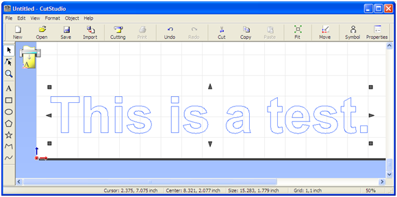

Step 2: Using the Software.
Open Cut Studio, the software bundled with the cutter.
Import your image. It should show up as a grayed out picture.
Right click on the image, then choose Trace Image Outline
A dialog box will come up, you can adjust the accuracy of the cuts by adjusting the values.
You will see an outline of your image laid on top of the picture.
Click the Move button on the upper right to put the outline in the bottom right of the design area.
Next, delete the picture.
Right click on the picture and choose 'Properties'
There are three tabs. For size, choose the size that will fit your sample piece of vinyl. The cutter measures in millimeters.
If you need to rotate the image to fit the sticker size, you can do that in the 'Rotation' field.
If you haven't already,  to put a box, oval or circle around your image to make it easier to separate later.

    Someone is pulling your leg! "Software running the cutter" definitely doe NOT like .jpg or .bmp (or any raster-based) images. Vector graphics are the only way to get this to work. Do a google search on converting raster to vector and you'll find the solution. Most of us use Coreldraw or Photoshop to achieve this, but there are some free packages around you can use. Heck, I think even the free Libre Office drawing package can do it. For certain, GIMP can do it!
