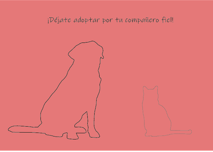

So the silhouette ends up like this, next thing is to choose the traze thickness wich goes according to your own criteria.
Step 9:
The rest is up to you, I personally will use the vinyl for lettering purposes with a pink color and the plotter cut in the silhouettes. In the lettering I will use a green vinyl behind so it creates contrast. In order to finish, It is very important for you to export the file to SVG format.
