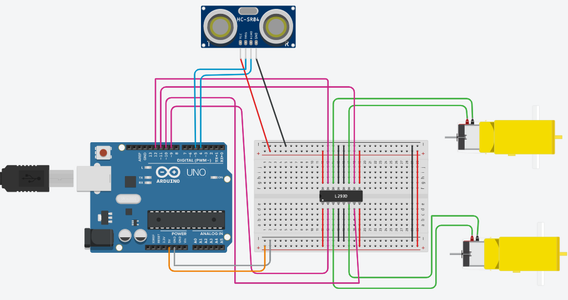

Step 2: Connections Between the Wires
Now, connect the wires in the pattern as shown in the figure.

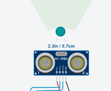

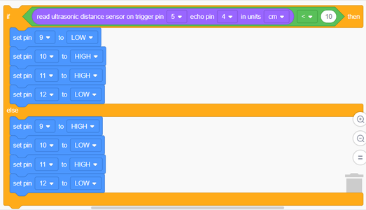

Step 3: Coding the Computer to Turn Left If There Is an Obstacle Within 10 Cm
In the code section, enter the code as shown in the figure.

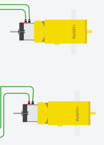

Step 4: Run the Simulation
Start the Simulation and drag the obstacle distance to less than 10 cm and you will notice that one of the motors RPM start decreasing, indicating that the robot will take a left turn.
