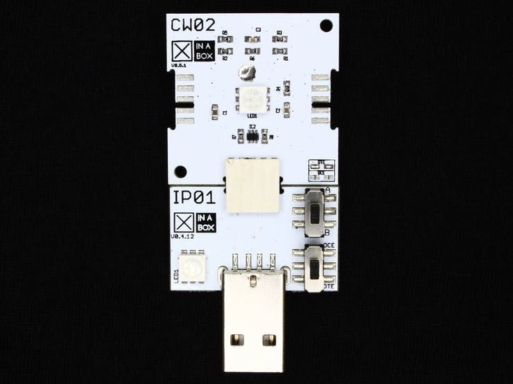

- Click the IP01 and the CW02 together using a XC10 connector. See image below:
- Insert the IP01 into your USB port
- Make sure the IP01 switches is in position B and DCE.

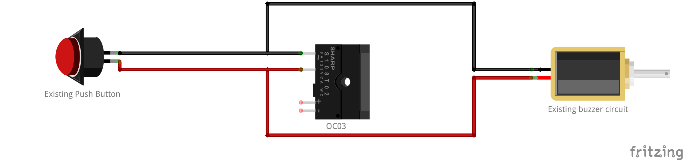

Plug the PU01 (or if you decided to stick with the IP01) into a USB power source. Connect wires parallel from your existing switch (leave that, just in case) to the OC03 (polarity doesn't matter). See Fritzing drawing.

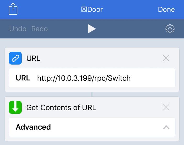

You can use any tool that can fire off an URL. I do it from an Apple App called Workflow, that allows me to do it from my phone or as a complication from my Apple Watch, but there are many other options out there. Here is my Workflow script, but with hardcoded IP address: Enjoy!
Apple App: Workflow - here with hardcoded IP address
Step 9: Schematics
