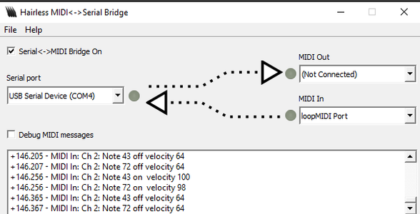

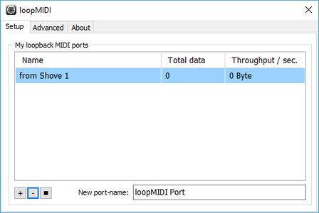

5. **Software to Connect Arduino to DAW**
- **Hairless MIDI**: This software bridges the serial output from the Arduino to a virtual MIDI device on the computer.
- **LoopMIDI**: Creates a virtual MIDI port so that the DAW can receive MIDI signals from the Arduino.
In the DAW, map the MIDI notes from the Arduino to the corresponding drum sounds, and you have a functional virtual drum kit.

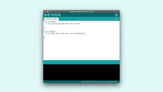

1. **Open Arduino IDE**.
2. Go to **Sketch** -> **Include Library** -> **Manage Libraries**.
3. Search for **MIDI Library**.
4. Install it.
Alternatively, you can work without the library since MIDI is being handled directly in the code.
### Running and Uploading the Code to Arduino:
1. **Connect your Arduino Uno** to your computer via USB.
2. **Open the Arduino IDE**.
3. **Copy and paste the provided code** into a new sketch.
4. Go to **Tools** -> **Board** and select **Arduino Uno**.
5. Go to **Tools** -> **Port** and select the port your Arduino is connected to.
6. **Verify the code** by clicking the checkmark icon at the top left.
7. If there are no errors, click the **Upload** button (right arrow icon) to upload the code to your Arduino.
8. Once the upload is complete, open the **Serial Monitor** (or use a MIDI interface connected to the serial port) to monitor the MIDI messages being sent when you hit the piezo sensors or use the footswitch.
This setup will allow your Arduino to send MIDI messages over USB, which you can use to control drum software or a MIDI module.

1. **Download and Install loopMIDI**
- **loopMIDI** creates a virtual MIDI port on your system, allowing MIDI signals to be sent between applications.
- Download loopMIDI from: [**loopMIDI**](https://www.tobias-erichsen.de/software/loopmidi.html)
- Install the software and run it.
- In loopMIDI, click **“+”** to create a new virtual MIDI port. Name this port something like **“Arduino MIDI”**.
2. **Download and Install Hairless MIDI**
- **Hairless MIDI-to-Serial Bridge** converts serial data from the Arduino to MIDI messages and routes it to loopMIDI.
- Download Hairless MIDI from: [**Hairless MIDI**](http://projectgus.github.io/hairless-midiserial/).
- Install Hairless MIDI and open it.
3. **Configure Hairless MIDI**
- In **Hairless MIDI**, select the **serial port** where your Arduino is connected (this will be something like `COM3` on Windows or `/dev/ttyUSB0` on Linux).
- Under **MIDI Out**, select the virtual MIDI port you created in loopMIDI (e.g., **“Arduino MIDI”**).
- Make sure the **baud rate** matches the one set in your Arduino code. The default baud rate in your Arduino code is set to `38400`. You must change this in Hairless MIDI under **Baud rate** in the settings.
Changing the Baud Rate in Code and Hairless MIDI:
- In your Arduino code, the baud rate is set with `Serial.begin(38400);`.
- Ensure that the **baud rate in Hairless MIDI** matches this value. Hairless MIDI will not work if the baud rates are different.
4. **Testing the MIDI Connection**
- Once everything is set up, you should start seeing MIDI messages in the Hairless MIDI window when you hit the piezo sensors. This confirms that the serial data from the Arduino is being converted into MIDI messages correctly.
- If there are any errors (e.g., MIDI buffer overflow), try increasing the buffer size or lowering the baud rate slightly.
