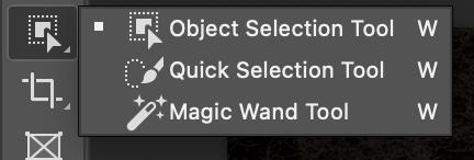

  • Use Object Selection Tool to select the subject. It should appear in blue when you click on the subject. When you press enter, the border around the selection will be animated (marching ants). Press Select>Inverse, and then press delete to remove the background. Press Select>Deselect (or Command + D on an Apple computer)

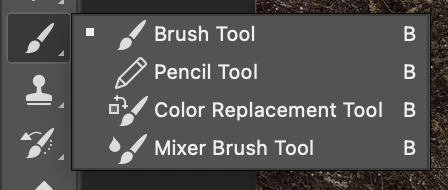

  • Click on the brush tool. Click and hold the little triangle and move down to the Mixer Brush tool.
  • Set your options as follows:
  • Soft round brush
  • About 20-30 pixels
You can sample colors from the picture to paint with. Click the Eyedropper tool or, simply press Option/Alt to toggle between the brush and eyedropper tool.
