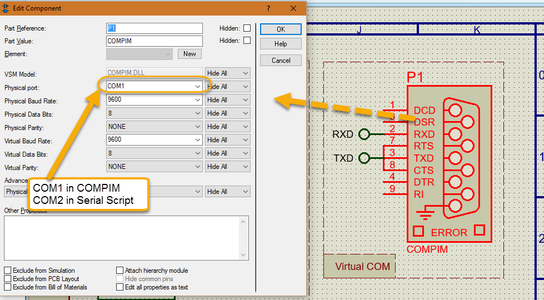

  • COMPIM : for connecting Proteus to Blynk server
  • Virtual Serial Port Software : for creating two virtual com ports, one to be set on COMPIM in Proteus, the other will be used when running blynk USB-ser.bat script

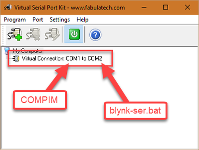

Step 2: Create Connected Pair of Virtual COM Ports
Use any virtual com port emulators to commit this step. I used fabulatech virtual serial port kit
  • COM1 : will be selected in COMPIM component.
  • COM2 : will be used later when running blynk USB-Serial script.

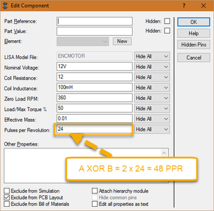

Step 3: Configure Servo Motor Properties
You can set the number of pulses/rev generated from each encoder pin. I chose the default of 24 PPR. Since xor is used, the actual encoder output will be 48 pulses per revolution.

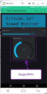

Step 4: Arduino Code
If you look at the Arduino code, you can easily distill it into portions:

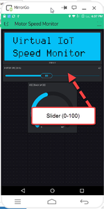

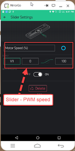

  1. Reading Motor Speed from Blynk App: This is done via using Virtual Pin. V1 is used to get the PWM value (0-100), and then map it to PWM Arduino range (0-255).
  2. Fetching encoder pulses via two interrupt pins. storing value in counter.
  3. Using timer to calculate the actual speed (count/time)

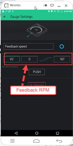

  4. Calculate actual RPM and send it to V2 vierual pin which is assigned to Blynk gauge.
Note : Gauge is heavily commented and if you can't grasp any part of it, just leave a comment and I'll happily respond on weekends.
