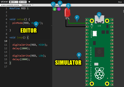

A - Editor window where you write code
B - Simulator window
C - RUN simulation button
D - Add Item Button
E - LED
F- Wires
G - Rspberry Pi Pico Simulator
online free simulator: www.wokwi.com

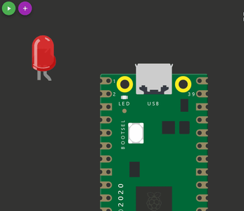

Step 1: Add an LED
  1. To add the LED, click on the purple Plus icon in the simulator window.
  2. You will get many options.. Choose the LED.
  3. By default color of the LED is Red. you can change the color of the LED in the diagram.json file if you want!
Step 2: Add the Raspberry Pi Pico Element
  1. The Arduino and Pico boards are not in the "ADD" icon list. to add the boards, you need to go to the diagram.json file.
  2. you can follow the image. visit https://docs.wokwi.com for the complete list

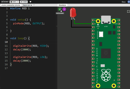

Step 3: Connect the LED and the Raspberry Pi Pico Using Wires
  1. Click and drag is supported
  2. you can drag the elements to the right position
  3. Click on the pin of the LED using your mouse. Then complete the routing by clicking on the destination pin
  4. Repeat the same for the other pin of the LED
  5. image shows how it will look
Step 4: The Software
The software is simple
We use the same style as Arduino programming in this example
  1. The LED is connected to pin number 2 (GPIO 1) of the Raspberry Pi Pico
  2. The SETUP() function and LOOP() function works the same as in the Arduino environment
The code is shared below as well
#define RED 1
void setup() {
  pinMode(RED, OUTPUT);
void loop() {
  digitalWrite(RED, HIGH);
  delay(2000);
  digitalWrite(RED, LOW);
  delay(2000);
Step 5: Raspberry Pi Pico Simulator in Action - Execution
Click on the RUN simulation button to see the Raspberry Pi Pico simulator in action! The LED will turn off and turn on every 2 seconds.
