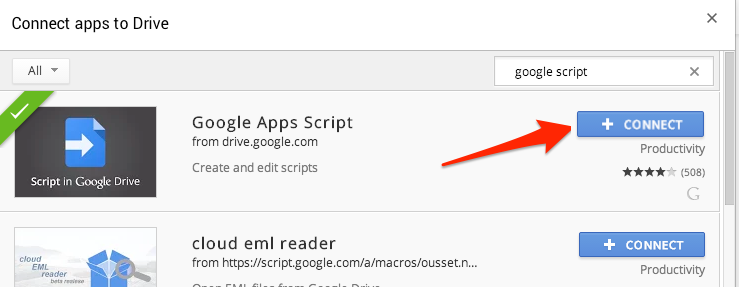

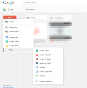

- Click New>More>Connect more apps. (image one).
- Search for Google Apps Script when it comes up click connect (image two).
- To open the app click New>More>Google Apps Script.

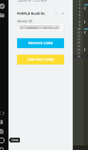

Continuing in Google Apps Script, find the text "PUT YOUR DEVICE ID HERE" in the code and replace it with your device ID . Your device ID can be found in the "Cores Page" of spark.io/build (Click the Core Page icon on the bottom left, to open the Cores Page - first image).

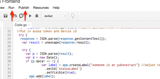

At the top of the Google Apps Script page click Run>doGet. The app will then prompt you for permission to send a signal to the spark.io server. Click allow. It looks like it did absolutely nothing! However, this was important because you needed to give the script access to run the UrlFetchApp.fetch() line.
At the top of the Google Apps Script page again, click Publish>Deploy As A Web App. A window will popup allowing you to click "Save New Version" and then "Deploy".
