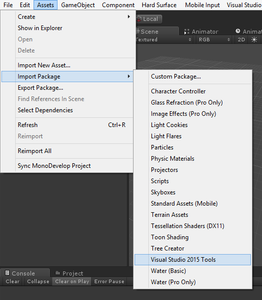

Open the game in Unity. Go to Assets> Import Package> Custom Package. Navigate to the Unity Visual Studio package and select it.
IMAGE 1 ABOVE
After selecting it, Unity will prompt you to import the package. Click Import.

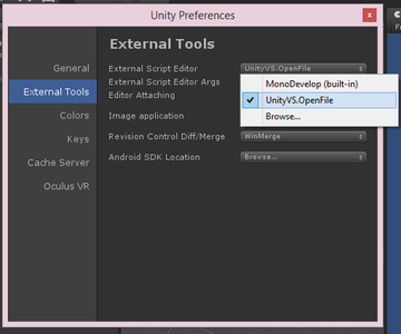

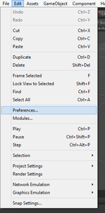

Next we have to specify that we want to use the Visual Studio IDE instead of MonoDevelop.
To do this we navigate Edit>Preferences
IMAGE 2 ABOVE
Go to External Settings
IMAGE 3 ABOVE
And Switch it from Mono Develop to Visual Studio. And there you have it! One small caveat. On each new project you create you still need to go to Assets>Import Package> Visual Studio Tools, and then confirm the import.

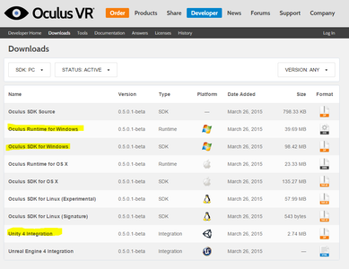

First, we need to grab the Oculus pieces from their site. You can go to their download section. Now if you have a Mac or Linux, download the appropriate links for those operating systems.
IMAGE 1
After you download the links you now need to install the runtime. Then restart your computer.

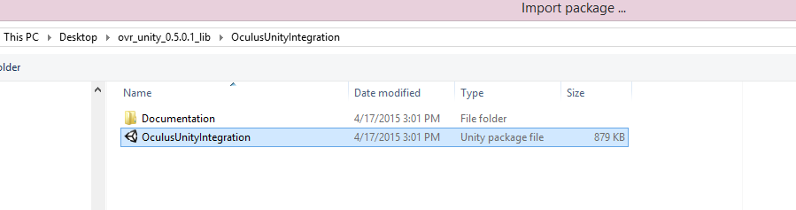

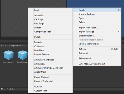

Extract the files from the Unity Integration Package you downloaded. Go Into Unity to Assets>Import Package>Custom Package
Find where you extracted the files and navigate to the Unity Plugin.
IMAGE 3

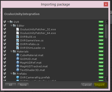

Then double click on the package. Once you do, Unity will pull up all the files in the package and prompt you to Import them. Hit Import.
IMAGE 4
Now you should have a new folder in your Assets called OVR.

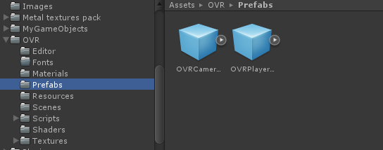

This new folder will have all the files that you’ll need to add virtual reality to the game.
Step 3: Using and Scripting Oculus Camera
Now using the Oculus Package is super easy. Oculus has already created prefabs for developers to use. They have a prefab with just the camera rig as well as one with the rig and a character motor.
IMAGE 1
To use them just Click and Drag it into your scene. I placed the OVRPlayerController at 0, 2, 0.

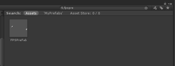

Now in the scene add the FPSprefab in the project by searching for it in the assets folder.
IMAGE 4
Click and drag it into the scene like you did with the OVRPlayer Prefab and place it at (0, 0, 0).

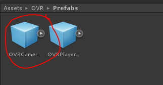

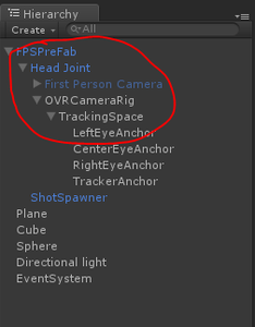

Next Drag the OVRCamera Prefab into the scene under the Head Joint of the FPSPreFab.
IMAGE 6
IMAGE 7
After that disable the First Person Camera.
IMAGE 8
The OVRCamera Rig is perfect for this situation since we already have a working player we want to use. Move the FPSPreFab to (0, 2, 0) and Run the game. It should look like this: (And the arrow keys or “wasd” will still control movement and mouse/head will control where you look).

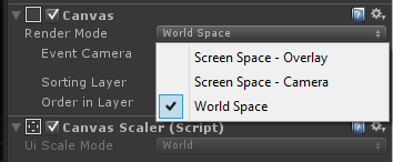

1) We need this UI to be in World Space. We do this by selecting the OVRCanvas and then Unity under Canvas>RenderMode and in the pull down select World space.
IMAGE 3 ABOVE
IMAGE 4 ABOVE

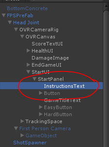

2) Change the Instructions Text
IMAGE 5
IMAGE 6

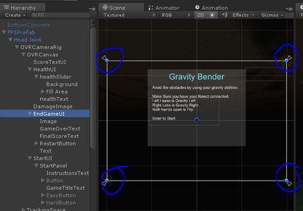

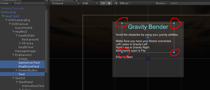

We aren’t done yet. We also need to readjust the End Game UI but we can achieve this the same way we did it with the StartUI.
Select the Start UI from the hierarchy and select the 2D button in the Scene Tab. In general it’s easier to work with UI in the 2D mode of Unity.
IMAGE 7 ABOVE
IMAGE 8 ABOVE
We don’t really see anything in the scene. That’s because at the start of the game the only thing in the canvas that we want to see are the instructions. However, we do see a rectangle with blue circles on the corners surrounding the Canvas. That rectangle signifies the space where the End UI will be shown. Now in Oculus the view finder is a bit limited since we have the canvas in world space. Therefore we need to move the contents of the UI to the viewing area of the users vision; which happens to be the instructions box.
To move it we need to make sure that the anchor movement tool is selected and not the regular transition tool.
IMAGE 9
IMAGE 10
Then we can move around the contents towards the center of the screen. By clicking and dragging. When you have certain parts of the hierarchy selected their corresponding positions in the scene will have the blue cornered rectangle around them.

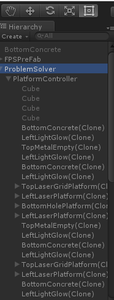

Currently all the platforms in the Game are children on the Problem Solver game object. This is how all the rotations can be applied to even the newly spawned platforms. So we can easily deactivate them by deactivating the ProblemSolver.
IMAGE 1
In the Game Controller’s Update method there is this section of code at the bottom:
if (playerHealth.currentHealth <= 0 && !gameended)
InitializeEndGame();
if (gameended)
{ restartTimer += Time.deltaTime; // .. if it reaches the restart delay... if (restartTimer >= restartDelay) { // .. then reload the currently loaded level. Application.LoadLevel(Application.loadedLevel); } }
What this does is display the Game End animation canvas, which is already created, and after a specified amount of time the game restarts. Now when in the IntializeEndGame method add the following line:
        problemSolverObject.SetActive(false);

Now when the game ends we can see the End Screen.
IMAGE 2 ABOVE
Okay so all that’s left to do make a key board trigger for the restart and change the UI of the EndGameCanavas to inform the user how to restart the game.
To change the text repeat what we did with the StartUI.
IMAGE 3 ABOVE
IMAGE 4 ABOVE

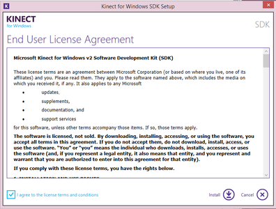

IMAGE 1
After you download the SDK, run it. You will be prompted with a Kinect for Windows Setup wizard.

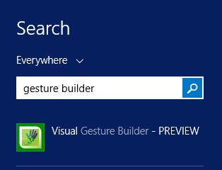

After you install the SDK you should have some new programs installed on your computer.
· SDK Browser
· Kinect Studio v 2.0
· Kinect Gesture Builder
IMAGE 3
The SDK Browser will be the most useful of the new software, because it contains links to all the other programs/software as well as demos and example code you can use.

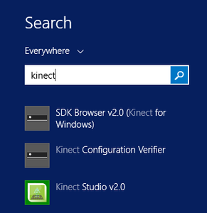

Once you Plug in the Kinect to the USB3 port on your computer we can test the connection with the Kinect SDK applications that were automatically downloaded.
Open the SDK Browser for Kinect. The first program in the list should be the Kinect Configuration Verifier. Run it. The Kinect’s light should now turn on if it’s connected properly and the Verifier will open a window, if everything is correct, it should look like this:

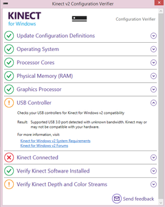

If something is wrong you will get a red X identifying the error:
IMAGE 6
Even though I have a warning about my USB port, my Kinect still runs. Now to see the information collected by the Kinect we will run Kinect Studio. It will be the third item in the SDK browser; or you can open it straight from your applications.

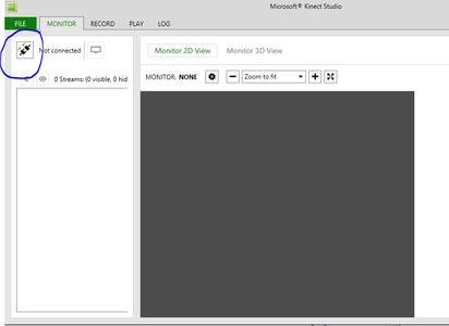

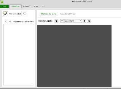

Kinect Studio looks like this:
IMAGE 7
Don’t worry if you don’t see anything. At startup. Although your Kinect is on and streaming data to your computer Kinect Studio isn’t reading in that data yet.
You need to hit the plug icon at the top left hand corner so you can see anything.
IMAGE 8

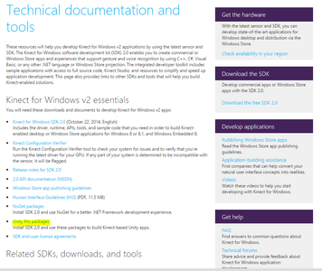

First step is download the Kinect for Windows Unity Package. You can find it at this link: https://www.microsoft.com/en-us/kinectforwindows/...
IMAGE 10
To get started we will use the steps directly outlined in the Kinect for Windows Unity Package from Microsoft; but slightly edited since we already have a project created.

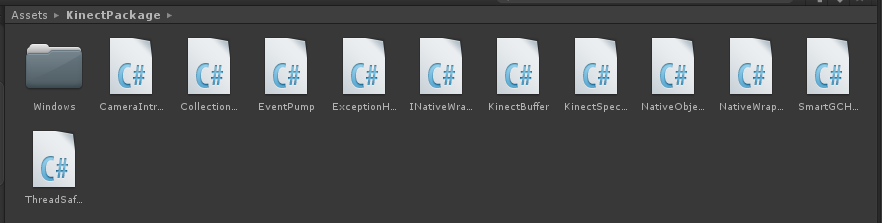

**Before you do step 8 here is an important thing to note – When Importing notice that the folder is called StandardAssets. This is the same name as the Sample Assets from the Unity Store. If you are using Unity’s Standard Assets package the import manager will embed the new Kinect files into the already existing folder. Be careful! If you don’t keep track of what you’re importing you might lose files within the numerous folders of your project. So, to keep things organized keep note of the files that are not in subfolders and are just in the Standard Assets folder.
In this case there are 10:
· EventPump.cs
· KinectBuffer.cs

8) Click "Import" in the lower right hand corner of the "Importing Package" Dialog (which Unity will launch after step 7)

Okay lets stay organized. Create a new Folder in your Assets Folder called KinectPackage. Then, add the 10 files I mentioned above as well as Windows Folder from StandardAssets.
IMAGE 11 ABOVE

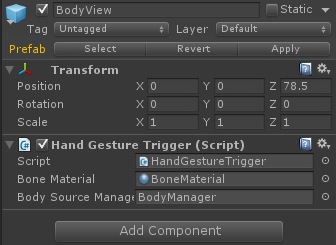

Step 8: Adding Kinect to Unity
Now in Unity I’ve created another scene by going to file new scene (it will prompt you to save your current scene if you haven’t already). This empty scene will make it easier for you to test and see what you’re doing.

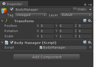

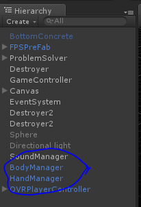

In the empty scene, which I have saved as kinectTest, create two empty game objects. Call them Body Manager and Body View.
IMAGE 1
Attach the Body Manager script to the body manager object. Attach the Body View script to the BodyView object.
IMAGE 2

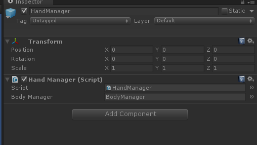

Select the Body View object. In the inspector you need to fill in the Body Manager slot and Bone Material slot. Click and drag the BodyManager from the hierarchy to the slot. Then in your materials folder click and drag the Bone Material into the bone material slot.
IMAGE 3
Now hit run. You should see nothing on your screen at first. This is because the Kinect hasn’t registered your skeleton yet. Stand back about 4 ft, and you should see the skeleton appear.
IMAGE 4
If you look closely you can tell that the legs of the skeleton are red. This is because the Kinect is interpreting that’s where my legs should be. My desk was blocking the sensor from detecting where my legs actually were.
But wait! You say. We don’t need a skeleton in our game, just the hand gestures and states! So was all this a waste? NO! Of course it wasn’t. We just don’t need to draw the whole skeleton in the scene anymore. But we now have the know how if you need to in the future. YAY!

Okay so let’s see if this works. In your scene create another empty game object and call it HandManager. Attach the handmanager script to it. Remember to drag the BodyManager from the hierarchy to the BodyManger placeholder in the HandManager Inspector.
IMAGE 1
Run the code in Unity.
IMAGE 2
Okay but we still see the skeleton. Well if we deactivate the bodyView by checking the left hand box in the inspector we can run the project again.
IMAGE 3
BAM! There it is, and you know it’s still working based on the Debugger even if you can’t see the skeleton anymore!
Okay now to add this into the game. First let’s make the prefabs out of the HandManager and BodyManager objects.
IMAGE 4
Once you’ve create them drag the Body Manager from the Hierarchy to the Body Manager Prefab you created. Do the same with the Hand Manager. Now as prefabs we can easily move those objects and functionality into our main game scene!
