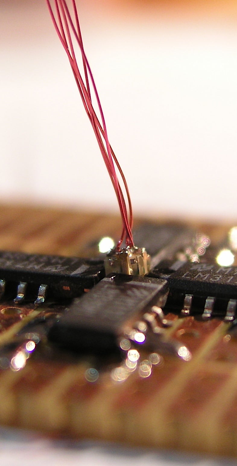

Step 1: Make a Tiny Workbench
We need a square hole about 2.5mm. I use 4 old SMD chips and solder them on a PCB together.
First you should solder only one pin. Then bend the chip in the right position and solder one or to other pins to fix the chip.
Be sure that there is one hole of the PCB in the center of the 4 chips. We need this hole later!

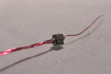

Step 3: Solder the First Wire
Now here is one of the tricky parts. ;-)
Use a very thin isolated copper wire.
Remove the isolation on about 3mm.
Bend a small ring like shown in the first picture.
Put the wire in the middle of the 4 SMD LEDs and place the ring on top. (Sorry no picture before soldering.)
Solder fast and carefully all 4 LEDs and the wire ring together. (second picture)
Now you can remove the 4 LEDs out of the "tiny workbench". (third picture)

Step 4: Solder the 4 Cathodes
Now put the 4 LEDs upside down back into the "workbench".
Solder all 4 cathodes from the 4 LEDs to 4 wires.
If you finished this very tricky part you become a multi LED with 5 contacts.
1 Anode and 4 Cathodes.
