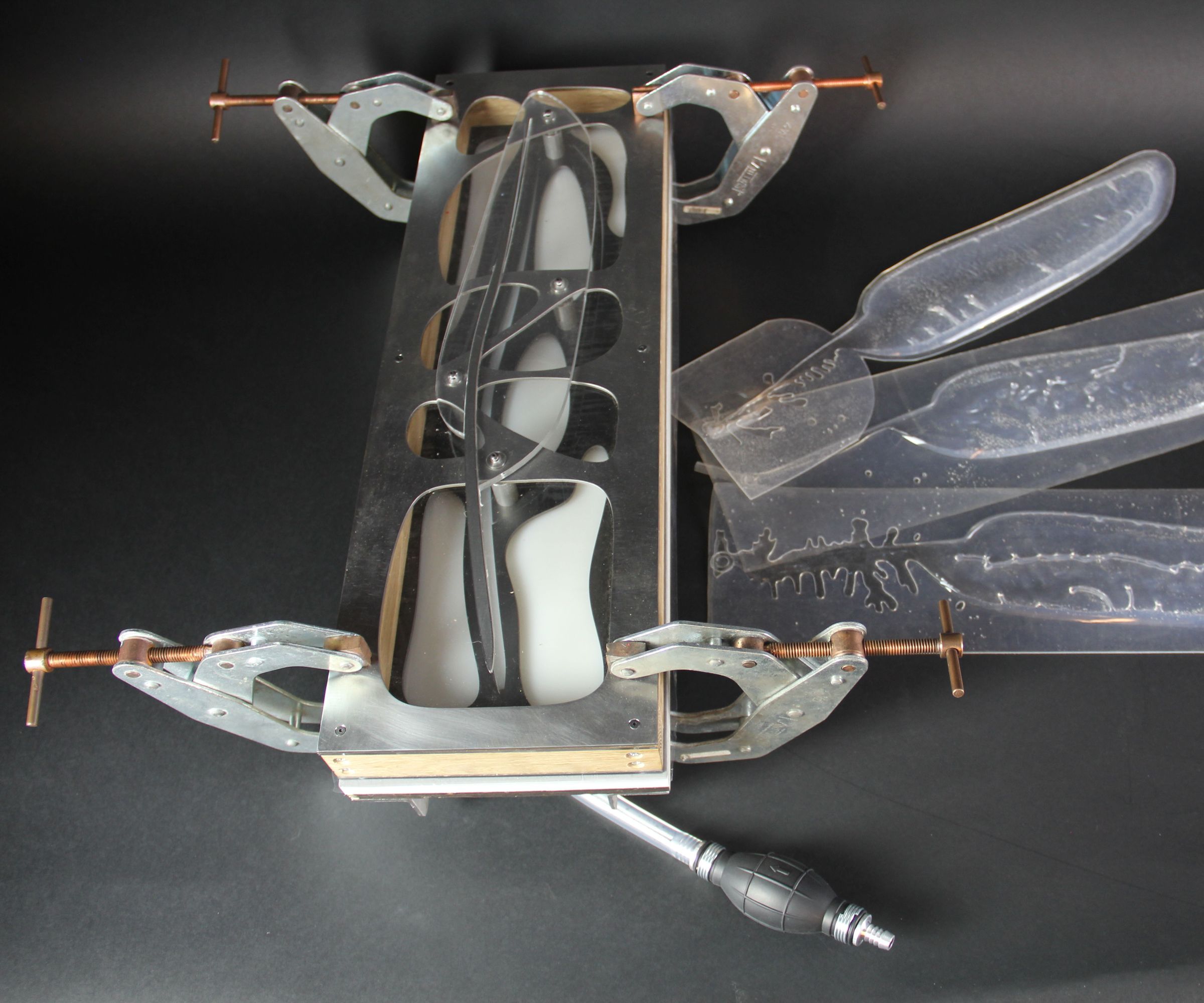

Step 5: Top Frame and Glass
For large sheets you will need a rigid frame above a sheet of rigid glass to control the height of your "2-Dimensional" cell. Rigidity gives consistency, but at a cost. It is essential that air have somewhere to go when injected. rigid systems can have pressure build up quickly. There are several solutions to this issue.
The glass should have thermal weather stripping (neoprene adhesive strips) of 1/2" on one side and 1/4" on the other following a perimeter just shy of the perimeter traced by the double sided tape. The overhang is necessary to ensure a tight seal at the boundary of the cell when clamped and under pressure.

The width of the channels depends on two things in this situation. 1: How high is the height of the cell? This is known as the gap thickness and the channel width scales linearly with gap height. One way I like to intuit this is to imagine the cross section of one of these "finger" channels as a circle, or something there abouts. As the height of the circle increases, so does the width.
Another parameter that you have control over is the ratio of the thickness of silicone to air. This may sound unintuitive but silicone thickens up during its pot-life. This can be taken advantage of by pushing the pot-life and injecting later. The thicker the substrate that you inject air into, the finer the channels (almost like shattering a liquid).
To insure that you get the appropriate flow rate of air (another factor that controls channel size) you should attach a pressure regulator to the air line, or use a large syringe to do the injection by hand, as I have in the first image where I am making my wearable (that cell is slightly different, in that it is just thin acrylic double taped to HDPE and the flexibility in the acrylic is what gives the air room to move).
One air is in, close the valves and let cure.
