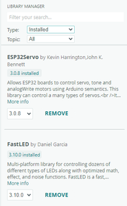

Step 3: Environments Used and Its Setup
We have used Arduino IDE to code for the functioning of the module.
1.Make sure you select the modules and give them respective ports to function.
2. Install the necessary libraries that are mentioned in the picture above.
3. The source is available in the link below
https://github.com/MoMakkawi/VisioLaser
