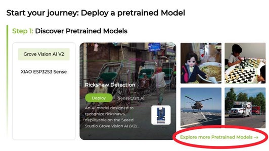

The first step is to flash a Pretrained Gesture Detection Model on the Vision AI Module V2. To do this, open the Chrome or Edge Browser on a computer and navigate to the SenseCraft AI website. Sign up for a SenseCraft account and sign in. Then, click the "Home" tab at the top of the window to see a series of steps for deploying a model. Under Step 1 ("Discover Pretrained Models"), click the option to "Explore more Pretrained Models" (see picture). A new window should open with pictures and descriptions of over 400 pretained models. Use the box in the upper left corner to Search for "Gesture Detection." Although several models will appear, only one of these will work with the Grove Vision AI V2 Module (see picture).
Clicking on the picture of that "Gesture Detection Model" will open a new window containing a more detailed description of the model. To initiate the process of flashing the model, click on the "Deploy Model" button. After making sure the camera is properly connected to the Vision AI V2 Moduie, attach the module to a computer with a USB cable and click the "Connect Device" button. Then, click the "Confirm" button when the popup window asks "Sure to deploy this model?" Another popup window will then ask for confirmation of the serial port. Select the appropriate port and click the "Connect" button. A darkened window will appear with a spinning wheel that indicates progress as the model is flashed to the Vision AI V2 Module.

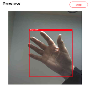

When flashing is done, the model will be running via its connection to SenseCraft. The "Preview" box mirrors what the camera sees and the "Device Logger" box shows data streaming from the Vision AI V2 Module as it continuously analyzes images from the camera. When a hand is placed in front of the camera, the model will attempt to classify the gesture as rock, paper or scissors (see picture).
After confirming that the Model is running correctly, click the "Disconnect" button (upper left) to end the module's connection to SenseCraft.

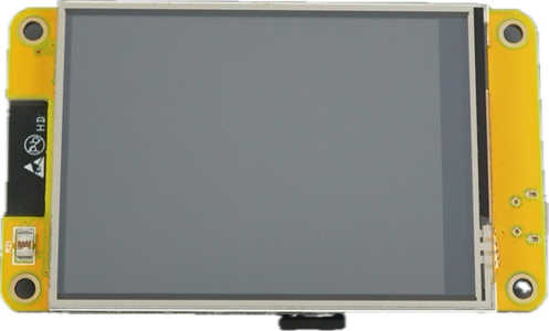

Step 4: Remove CYD's LED & Solder Wires to GPIO 16 & 17
The CYD has only three GPIO pins available to connect peripherals (see this Random Nerds tutorial). Unfortunately, this project needs four GPIO pins: two for the SDA and SCL pins on the Grove Vision AI Module V2 and two for the RX and TX pins on the DFPlayer Mini. My solution to this problem was to remove the RGB LED soldered on the back of the CYD (see picture), as suggested here.This modification makes three additional GPIO pins available, including 16 and 17, which were used in this project for communicating to the DFPlayer Mini.
Removing the LED is a tricky de-soldering task because it’s surface mounted. If you're intimidated by de-soldering a surface mounted component (like I was), watch a few YouTube videos first to get tips. My best advice is to use a lot of solder flux to facilitate getting the original solder flowing and to avoid pulling the solder pads off the CYD when you remove the LED.

The decision to face the camera up toward the ceiling was based on observing how the Gesture Model behaved while watching the "Preview" window in Step 2 (above). I discovered that there was less interference from other objects in the camera's field of view when it was facing up than when it faced me (Vision AI thinks my head looks like a rock). That solution will probably work with most ceilings (except maybe the Sistine Chapel). I also discovered that detection occurred more quickly and accurately when my hand was at least a foot or so above the camera. At shorter distances, there was a greater tendency for every gesture to be detected as a rock.
Based on some trial-and-error testing, the sketch selects the first gesture that is detected five times with greater than 60% confidence as the human's choice. As noted earlier, AI's choice is completely random and independent of the human's. According to the Espressif System API for the ESP32's hardware random number generator, true random numbers are produced when Wi-Fi is enabled. For that reason, the Setup function puts the ESP32 WiFi in APSTA mode even though the sketch makes no other use of WiFi.
