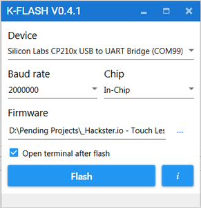

Step1: Update the firmware to the HUSKYLENSWithModelV0.4.9Class.kfpkg with K-Flash.

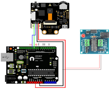

Step 4: Connection Diagram
The Arduino Pin 10 & 11 are used to communicate with HuskyLens.The L293D motor driver is connected to the Arduino Nano.
Arduino Nano -> HuskyLens
Vcc -> Vcc
GND -> GND
Arduino Pin 10 -> TX
Arduino Pin 11 -> RX
Arduino Nano -> L293D
Vcc -> Vss
GND -> GND
Arduino Pin 3 -> IN1
Arduino Pin 5 -> IN2
Arduino Pin 6 -> IN3
Arduino Pin 9 -> IN4
Make the connections as mentioned above.

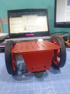

I bought a standard Robot chassis from a local store for $4. We have the BO motors on the left and right sides of the Chassis and a ball caster for balancing weight.
→Chassis with BO motor and Wheels

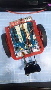

→Next, we mount the Husky Lens with the given L clamps and it turns like this.
→Now we add the Arduino and the Motor driver to the chassis. I've got 2 Lithium-ion cells to run this robot. These cells are connected in series to provide 7.4V. This can be replaced with Li-Po batteries too.
