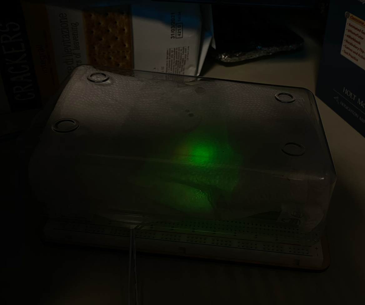

Step 3: Put Together & Decorate
The long cable used in this project creates a better way for users to connect only the LED light bulbs to the phone stabler. To stick the light bulbs to the stabler, you could use sticky clay or tape, I chose sticky clay so there won't be leftover glues on any of the used materials. Since LED light bulbs are light, you don't need superglue or stronger alternatives to put the pieces together. The speaker doesn't need to be attached to the phone stabler but feel free to do so.
After putting the pieces together, you could choose to decorate it as you wish, whether you want to put the whole device in a box or simply hide the boards and cables behind the phone stabler.
Step 4: Start Protecting Your Eyes
From now on, using electronic devices wouldn't be the reason of your eye sight worsening. The phone stand from this project would help you limit and get hold of your device using time well!
