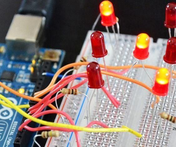

The ultrasonic sensor measures distance based on the time taken for the sonic wave to be received echo pin, after being transmitted by the trigger pin. We generate multiple "waves" by providing short-term delays to the trigger pin by switching it on and off.
We then began configuring the distances for which each range would have the buzzer and/or motor vibrate frequently, the closer you got to the object ahead.
Note: We used a buzzer and a mini vibrating motor to serve the purpose of aiding people with visual and/or hearing impairments.

Step 1: WIRING IT!
Begin by reviewing the detailed schematics provided to understand the layout and connections required for each component.
Carefully wire all components according to the schematics, paying attention to the following:
Connection Security: Make sure that each connection is secure to prevent any loose wiring.
Color Codes: Follow the specified color codes for wires to maintain organization and clarity in your wiring.
Component Placement: Double-check the placement of each component to ensure it aligns properly with the schematic.
Pin Orientation: Take note of any special instructions regarding pin orientation or component polarity. Use the pinout from the code provided below.
Ensure that all solder joints are clean and free from any shorts, as this is crucial for the circuit's functionality.
After completing the wiring, conduct a thorough visual inspection to confirm that everything matches the schematic before proceeding to power the circuit.
NB: The circuit diagram given doesn't show the real pins used in the code, so use pinouts from the code for each component, or you can just use your own pins if you like and edit them in the code.
