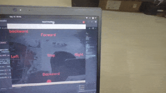

To begin with the the control of car from the camera, let us understand how it will function -
  • The camera must track the hands or fingers to control the movement of the car. We shall track the index finger on the camera for that.
  • Based on the location of finger with reference to the given frame, there will be forward, backward, left, right and stop motion for the robot to function.
  • While all the movements are tracked on real time, the interface program should send data while reading asynchronously.
To perform the above task in simple steps, methods used in the program have been simplified in beginner's level. Below is the final version
As we see above, the interface is very simple and easy to use. Just move your index finger tip around, and use the frame as a console to control the robot. Read till the end and build along to watch it in action!
