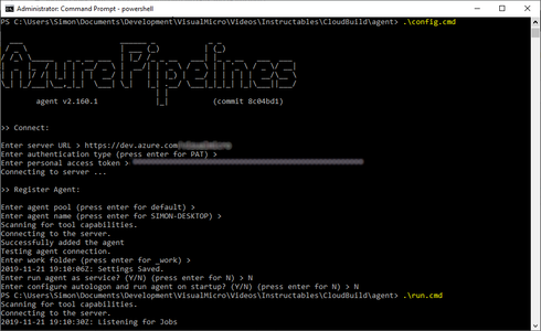

Step 2: Link and Configure Build Agent
We will need to configure the new Agent in Azure Dev Ops, and configure the Agent on our build server as needed which is detailed below:-
https://docs.microsoft.com/en-us/azure/devops/pipe...
Step 3: Configure Build Pipeline
Now we have an agent ready to build, we will need to configure our pipeline:-
  • Create a new blank pipeline
  • Ensure the sources are pointing to your checked in project (or GitHub/SVN/Git/Other Source)
  • Add a Command line task
  • Add commands to run VMBuild.exe as we need
  • Add any additional logging to the script (Environmental/user parameters are useful to log for debugging)
You can include pre-defined variables from Azure in your script directly e.g. $(build.sourcesDirectory)
Any further actions such as publishing the artefacts created back to your system can now be added as well.

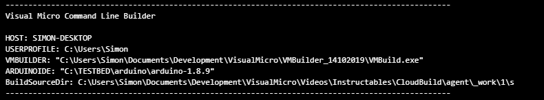

Step 4: Check Logging
As with all things ensure you have added some informative logging to the whole process.
The Visual Micro Command Line Interface assists with this by adding the below parameters:-
  • -builder.verbose=true
this will ensure all verbose messages are output
  • -builder.verbose_warnings=true
this will ensure all verbose warnings are also output
  • -builder-close=true and -builder-closeonerrror=true
this ensures the builder exits without need for input from the user
All Visual Micro CLI Parameters can be found here
