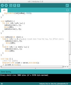

Step 3: Program Arduino
You need to attach the ethernet shield to the Arduino Uno, take note of the MAC address. Change this in the code attached. Also assign an IP address to the ethernet shield.

Step 5: Process on IDS
On the IDS you will run a python script that connects to the a listener on the Arduino. Run this out of cron, say every 5 minutes for a constantly updating display.
The code is fairly resilient and will fail with helpful messages.
Be sure to change the IP address of the Arduino in the file.
