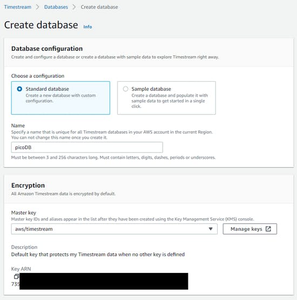

- Create DB
Enter the Timestream console and create a DB. Select Standard database, set only the DB name and click the Create database button.

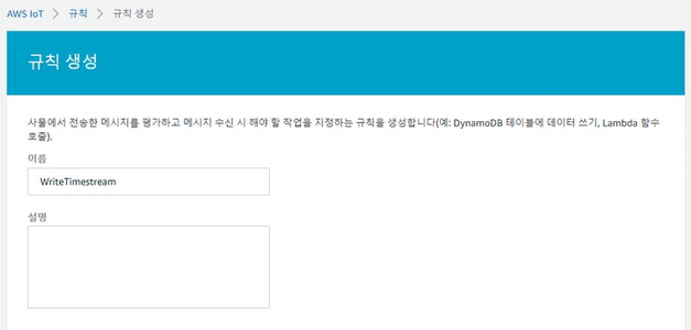

- Create Rule
AWS IoT Core > Rule > Create
Set rule name.

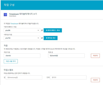

Timestream job configuration.
Set the DB and Table created above, and set the dimension to clientId. ${clientId()} is the value received from the device. There are only Temperature and Humidity in the MQTT message, but if you do this, the clientId is automatically inserted into the table.
Click Create Role and create a new one.
You can set it up by going to the IAM page, but if you set only a name and create a role here, the role is automatically set with permission to write data to Timestream, so it is convenient to create it here.
Also, if a pre-made role is used, even if the role can write to the timestream table, the role has limited privileges only for a specific table, so the operation is not performed properly.
It is recommended to make a new one and use it.
Error actions and tags create rules without separate actions.

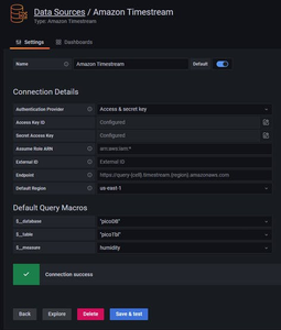

Setup Data sources.
Enter Grafana - Configuration - Data sources > Amazon Timestream
Timestream settings
Select Access & secret key from Authentication Provider and enter. Default Region is set to the region where Timestream exists. Default Query Macros set Timestream DB and Table. After completing the settings, click the Save & test button below, and if the connection is successful, a message of Connection success appears.

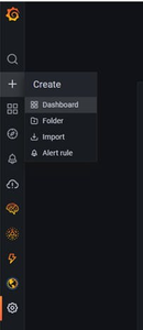

2) Setting Dashboard
Create - Dashboard
New dashboard created. Choose Add a new panel.
